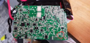

I have a BionX R320/R420 RIDE+ battery (01-3852) 48V/6.6Ah 316.8Wh.
Now when I charge it, I hear the 2 beeps, the orange light is not lighting-up, but the Green light is lit continually.
I see power is going in (the charges takes 70 to 90 watt, but is it stops charging after a few minutes and then the green light is blinking green slowly.
Somewhere I found out this is due to over-voltage of over-temperature.
At least over-voltage is not the case in my opinion, since the battery pack is only 50.4V.
Also the cells (parallel groups) read 3.73V to 3.84. Not too much out of balance I guess.
Also I don't see the battery-pack itself getting warm with my FLIR.
What I see is that one big component on the electronics board is getting warm (the WE 74435573300 / T1601), but I guess this is not necessarily bad I guess.
I also have measured the 2 temperature sensors that are going to the pack and they both read 9.5 (on 20k) resistance.

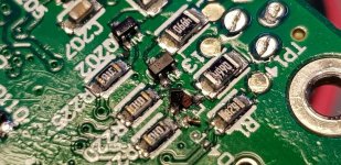

The only thing I can find that is really broken is one really small resistor (SOT-323?) with the marking 1P5.
I want to replace this, but can't seem to find this component so I don't know the specifications.
Also I wonder if this component is not just to light a LED.
Hope anyone can help me with some debugging.
