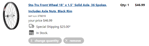

I feel very lucky, found a wheel with 3/8" axles; this axle measures 9.5mm diameter which is an exact fit to my front fork's slightly oversized dropouts. I get 2x the wheel - fork contact this way so losing QR is not a negative.
Will run with a BMX 18 x 2.3" on it. The rim should take a 2.5" maximum which i think is enough wiggle room to get adequate traction.
36 spokes is overkill, but with some work, this could be an 18 spoke wheel. The Cannondale front 16" has 16 spokes, and that bike sits you +2 inches up front, so i think 18 spokes would be equivalent strength.
Brakes? i'll use vbrakes with a box 2 brake post extender to make the calipers fit/align.

that looks like the right wheel for sure, and I think a solid axle is fine in this case. I would suggest leaving it as a 36-spoke as the weight of 18 spokes is pretty minor when you have electric assist.
