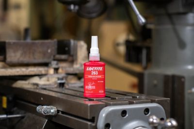

It's tough stuff. When the time comes for removal, my speculation is that red threadlock can be softened by acetone: tap lightly with hammer, apply acetone, attempt to turn the bolt both ways, apply acetone, hammer lightly etc. I'll need to try that at some point, before reaching for the blowtorch. Bear in mind acetone can also dissolve paint.
Yeah i don't trust any glue to be vibration resistant enough to handle getting rattled at 40mph on 20" wheels for a long period of time!
Wrap it with heavy duty rubber band (long strip of bicycle inner tube) and it's not going anywhere. Do a neat job and it should look quite presentable.
Red hot? Don't think so. 500 F with small butane torch softens it to be easily removed.
Perhaps I have been unreliably informed, or reliably misinformed. Thanks, will try that when the time comes, if acetone doesn't soften the red gunk.
To ease your mind. Put some Red on a nut and bolt you don't care about. Let it fully cure and try the torch.
Anyway, red seems like overkill for this application (battery mount fasteners?). Blue should work fine.
Keep in mind that there's very little holding stress on this mount and 6 bolts that are 2x larger than the 2 bolts that would normally hold the motor.
Trust me, it'll be fine!
Rather like superglue, red threadlock sets within it's container fast; now a solid useless lump - no chance of a drop squeezed out three years later. Thats a good thing, because my mind being eased would unease my mind accustomed to being in a constant state of unease, I'm not sure I could cope with such radical change.
I have my doubts about that, it's easy to break blue threadlock. That part of the frame flexes, would flex a little more without the stiffening effect of the mount, between the letter "R" and the end of the second letter "A" especially.
