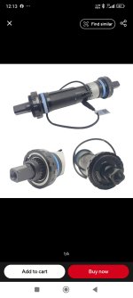

I have purchased a bafang bottom bracket torque sensor . Now which controller can or pulse ? And ideas. 1000w hub.. thanks
