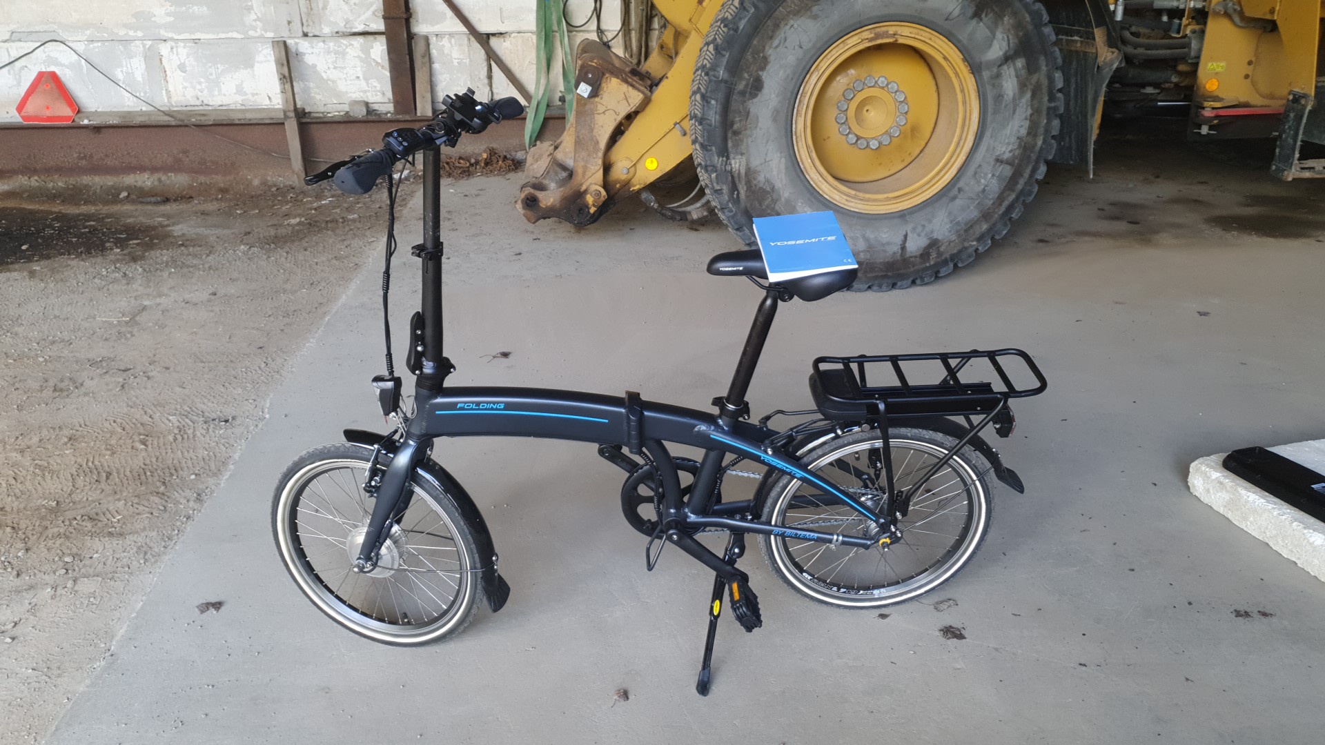

So a friend of mine picked up an Ebike a couple of days ago and has asked me if there is anything that can be done to let it go by motor alone.
I explained that it wont be very torquey as the motor is only 250w but he still wants to see what can be done and so do i.
Before i got a look at it i checked out some of what is around, it seems that in many cases a PAS setup is a magnetic sensor (reed switch?) that will detect if the crank is turning, and if so, drive the motor.
Hacks ive seen have been varied, like moving the PAS sensor from around the crank to one of the forks and putting magnets in the spokes to trigger it as the wheel turns, or mounting it in a different location and putting a magnet on a spring which will get to wiggling across the sensor with the motion of the bike, or even installing a blinker circuit with a controllable pulse rate instead of the PAS sensor, thereby making the motor power on without pedalling.
When i got to see it at work today i tried tapping the sensor with a magnet and that had no effect.
Does anyone here have any suggestions for what can be done to achieve pedalless power?
The bike in question:

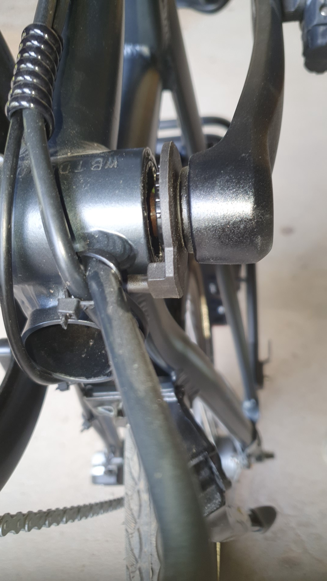

PAS sensor ring pulled out about 1cm, squarey bit at the bottom with the cable going into it is likely the sensor:

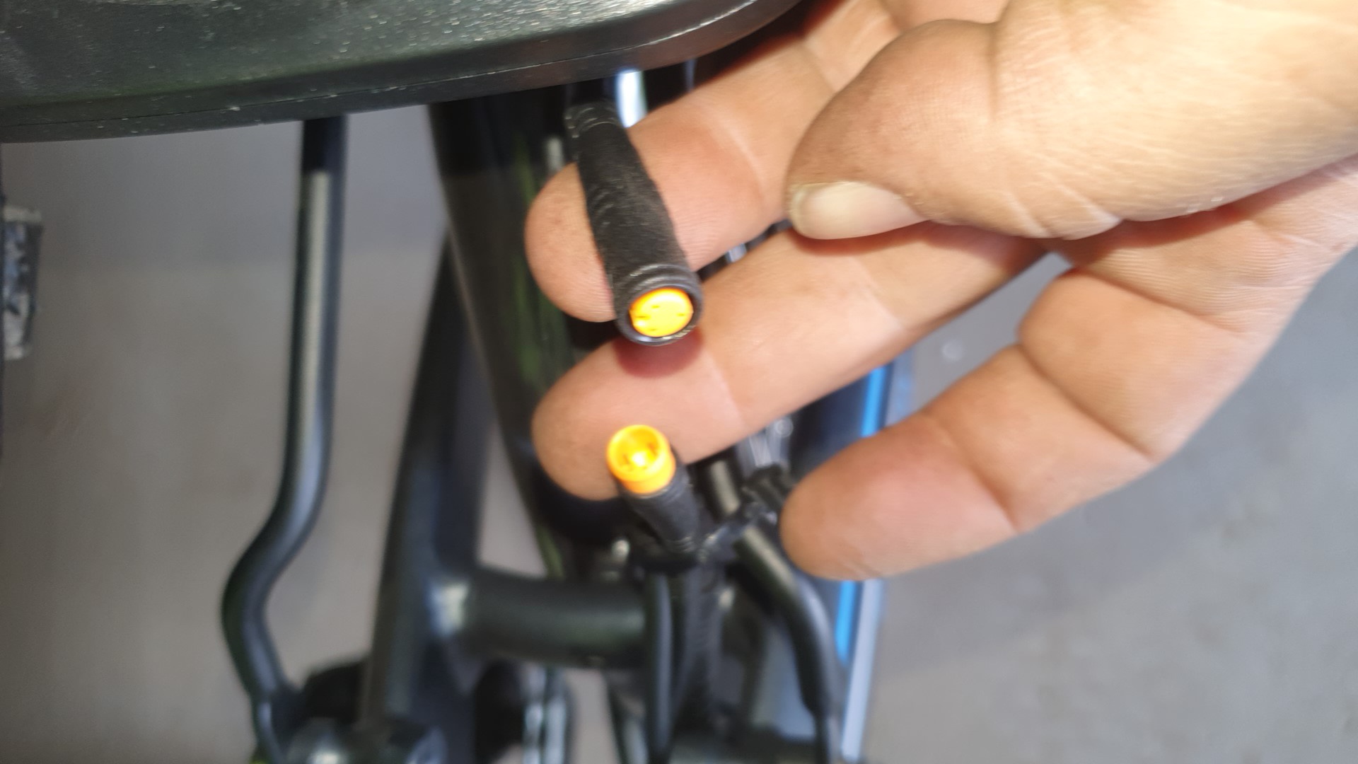

PAS sensor cable connection as it did not power the motor at all when disconnected but the display still lit up:

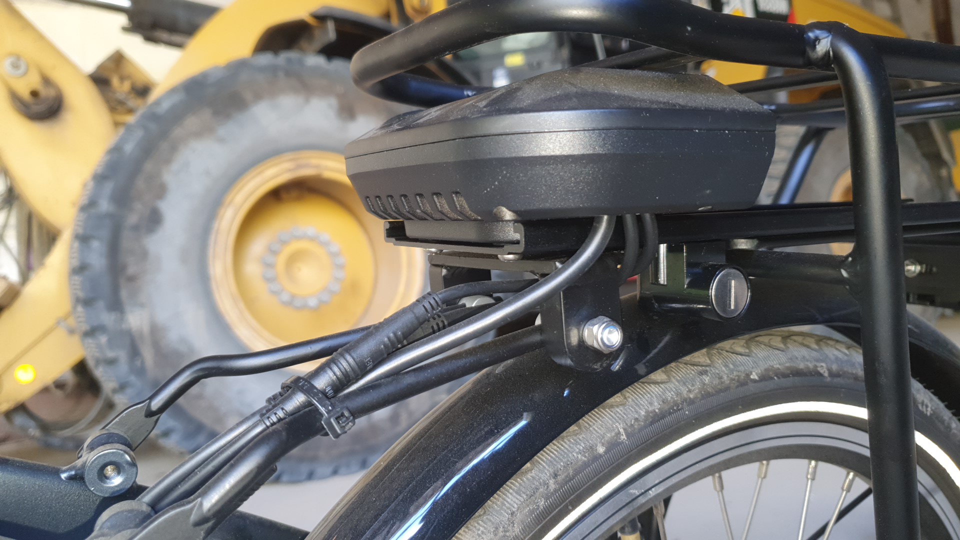

Likely location of the controller, the batter goes in below the cargo rack, the box has prongs over which the batter slides to connect, the connector by the ziptie is the separated one in the previous pic:

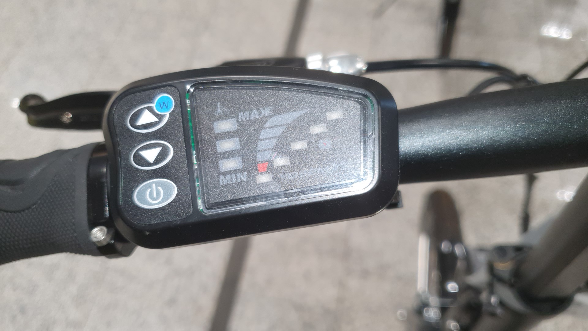

Display:
You can get what you want by substituting a cheap generic headless controller and the throttle of your choosing. But the components already on that bike are not designed to do what you want, and you are likely to waste more time than the problem is worth by trying to retrofit them.
If you're lucky, the controller is so generic that it supports a throttle, but to find out, you will have to look at it instead of looking at the box it's hidden in. It's doubtful that the manufacturer provided a capability they had no intention of using, so sell into a market that's not allowed to have that capability.
On the plus side, if you swap controllers, you can increase power to whatever the battery is rated to supply. The battery might say what that is somewhere on it, but again, you'll have to look at it.

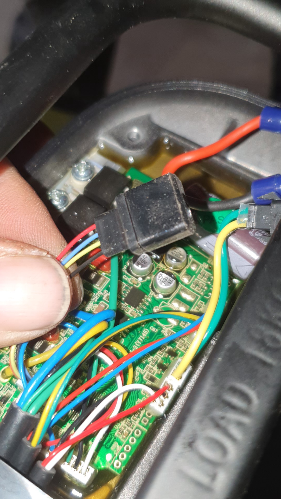

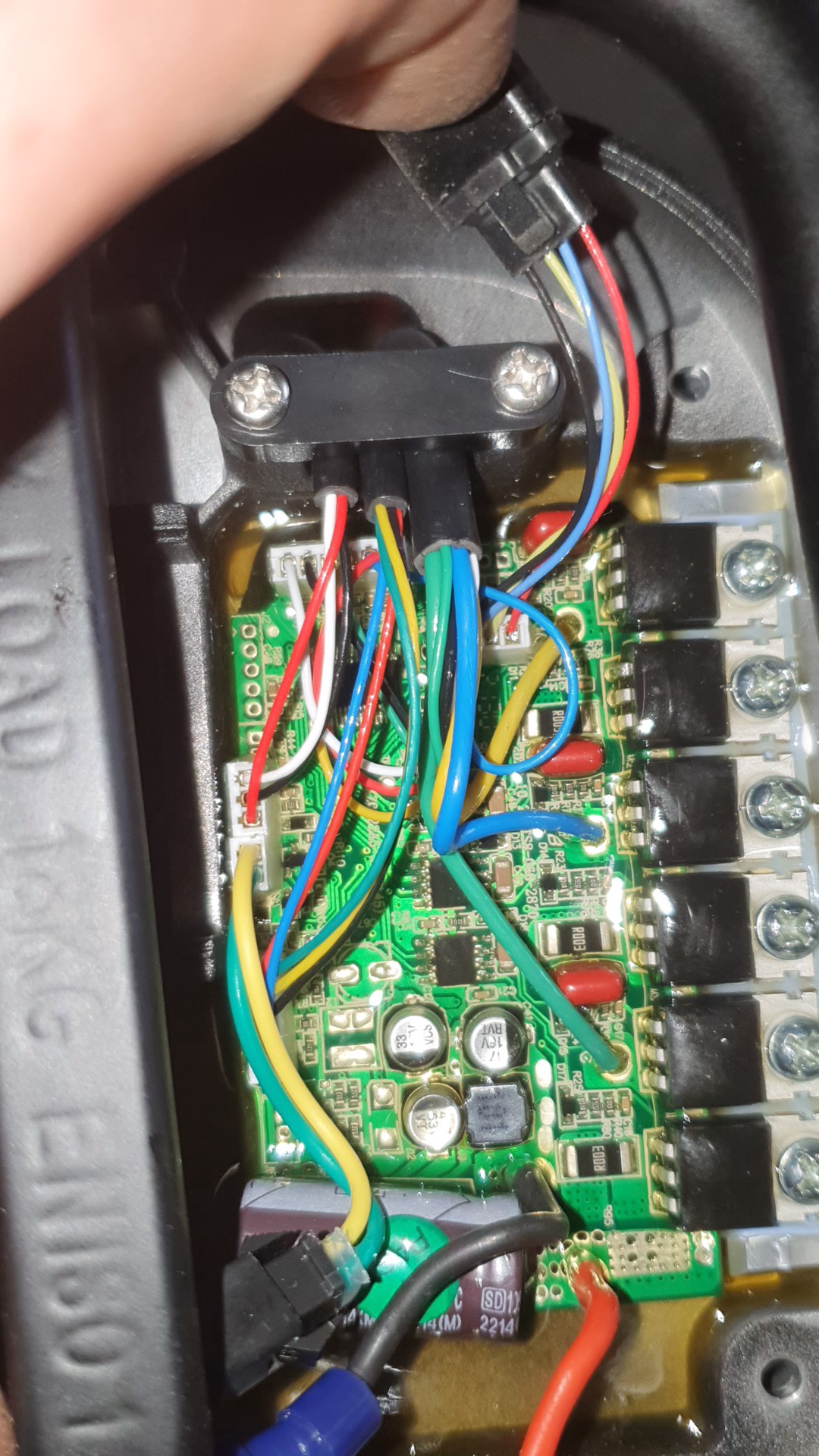

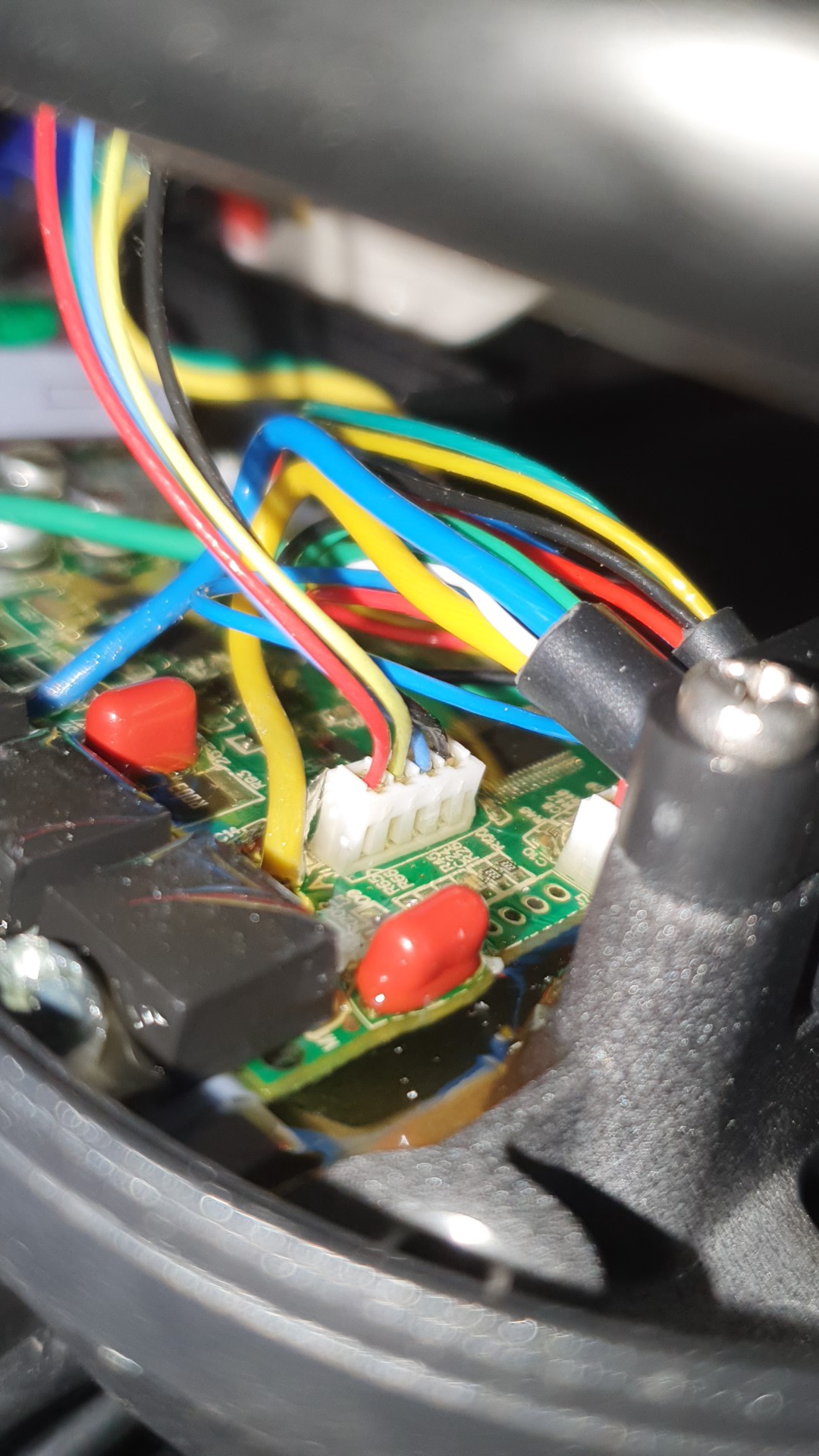

Had some spare time at work today and opened up the box housing the controller:
There is a spare connector but it has 4 wires, com port?
Wasnt able to read anything that was understandable to me where it plugs into the board:
Ring any bells for anyone?
I'd just change controller and throttle. Short the damn PAS.
Display, no display, whatever.
On/off & throttle. That's all you need.
