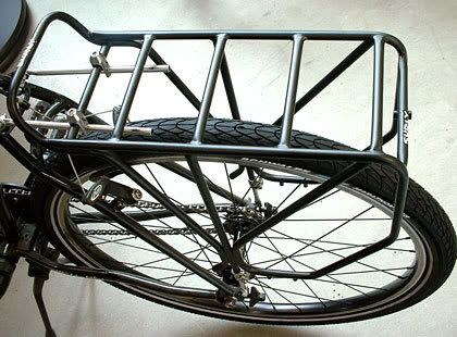

The charge indicator lights are - red, and 3 green lights. I am charging it for the fourth time and it does not want to go above the first green light. I am hoping that it will charge fully. I'll mount the speedometer this weekend to get some numbers. I also have to buy some new pedals, a rack, and put replace the stiff seat.

Sorry about the crapy indoor pics....

Got a picture of the batteries?
I have not taken a picture of that. If you look at the second picture, under the crank where the downtube ends, you can see a silver cover held on by 2 bolts.
I see it now. Thanks.

xyster: I think I was interperting the charge indicator lights incorrectly. The low green light is the brightes and the mid / high are much dimmer. They are on now, and go off as I ride. I will be testing the range this week. I rode it to work and will ride it back without charging. It better make it! Only 12 miles!
I don't know where the controller is. What does it look like? I'll add a pic of what I think the controller is, let me know if this is it.
