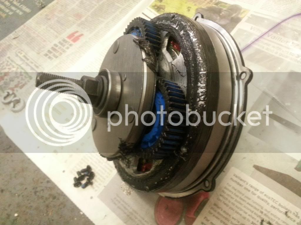

and it took 2400 watts but I jumped off a curb onto a hill and snapped the carrier for the planetaries.
it was the stress on the keyway pushed it up out of the seat and put pressure on the carrier.
but the motor took a lot of abuse to cause this.

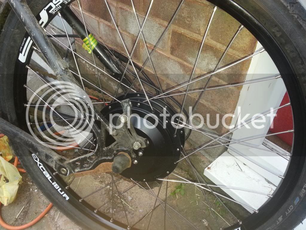

I recently got a Xofo motor. It's a copy of the Bafang CST, and has the advantage of a cassette spline. I also have a 500w Bafang CST to compare it with.
It was very easy to fit, slotting straight in to my 135mm drop-outs, and of course the cassette spline makes the gearing easier to sort out with a 11T top gear.
The max speed is about 20.5mph on the road with a 36v battery, and it will comfortably reach 30mph at 64v. No-load speed was 34mph at 64v. The power is about the same as the Bafang using the same 30 amp controller, and its hill-climbing is about the same too, which is pretty good. I'd say that the Xofo is a bit quieter, and when you spin it, it free-wheels for longer than the Bafang.
Overall, it feels good, but I can't say whether the build quality is as good as the Bafang's because I haven't opened it yet.
Weight is 4.2kg.
Other side before I fitted a 180mm disk

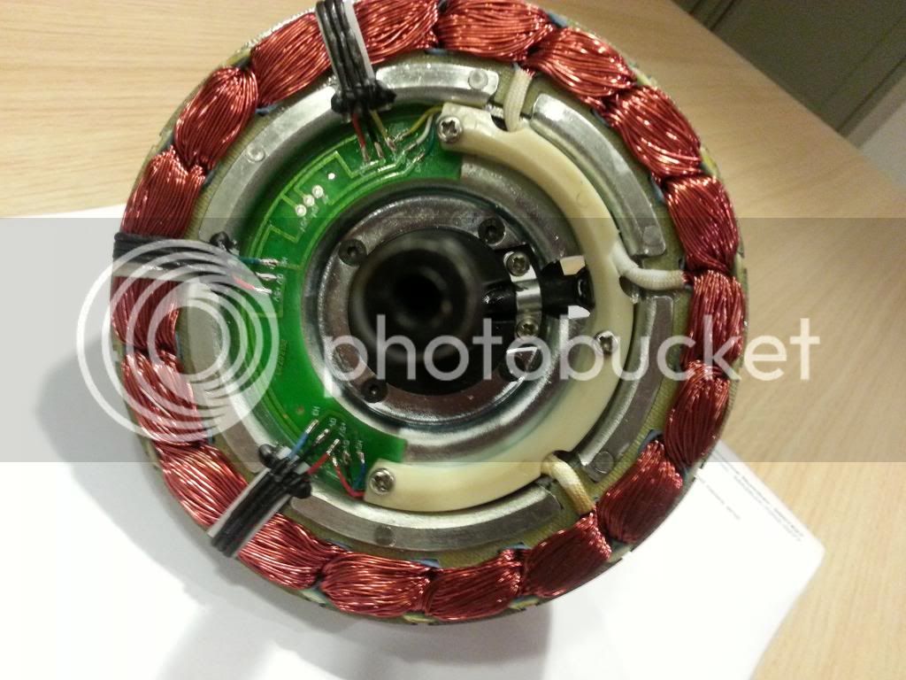

Bafang CST 500W motor
Approx 25.5 - 26mph no load speed @ 36V on KU123 (30A) controller
On-road speed 22-23mph on the flat. Good climber.
Internals

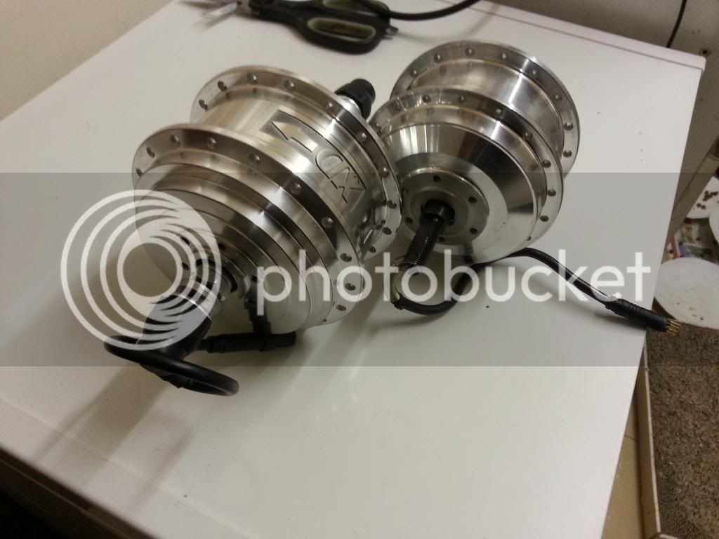

I've just been testing the Xiongda 2-speed hub-motor. It works perfectly, though a little noisy. As far as I can figure out without opening it, it changes speed by reversing direction. It's fully automatic. It cuts the power for half a second to change gear. I'm very impressed by the way they pulled that off. It works much better with 12S lipos, and can go up a 14% hill without pedalling and with a total weight of about 130kg. It's about 150mm wide with a seven speed DNP free-wheel on it, so I had to stretch the frame a bit to fit it in. Weight is 3.3kg, and it's the same size as a Bafang QSWXK5
Compared to a Q100:

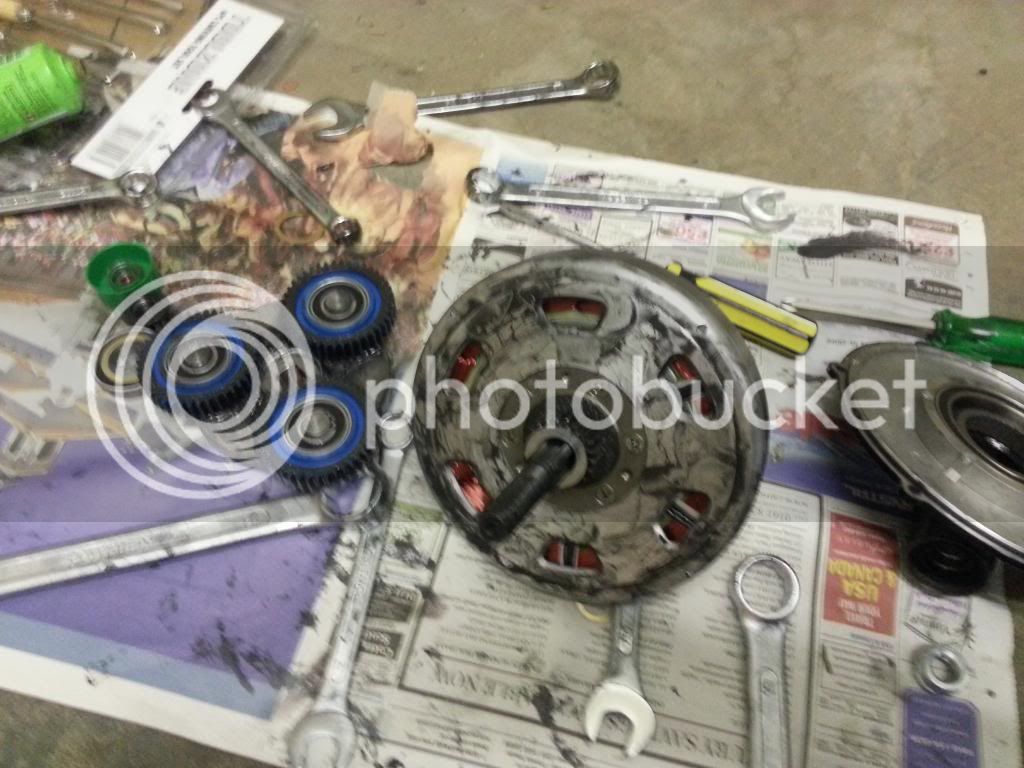

I have just about finished rebuilding my 2 speed Xiongda after catastrophic gear failure after about 500 miles. Apparently this is not usual, as I have seen no other reports of gear failure. Yona of Xiongda sent me a rebuild kit, together with grease that looks like plumbing caulk. Very fast 5 day service and a company that actually cares. I'll post in the 2 speed motor thread as I get back on the road this weekend. I really like this motor!

My rebuild is going to be quite problematic since I had to drill out some of the soft SS screws holding the ring gear in place. I think I am just going to order another new one (just the motor) and see if it holds up better. 500 miles per motor is not great. I will finish the rebuild this week and test it with the older controller in case I screwed it up. One of my problems (my fault) was nicking the wire bundle when using the puller. I think it will be OK but if it shorts it may take out the controller,so it is lucky I have the original KT. Xiongda did send their newest KT at no charge which works much better and has very accurate shift patterns. Quiet too.
I really like this motor, but reliability is also important. Stay tuned.
