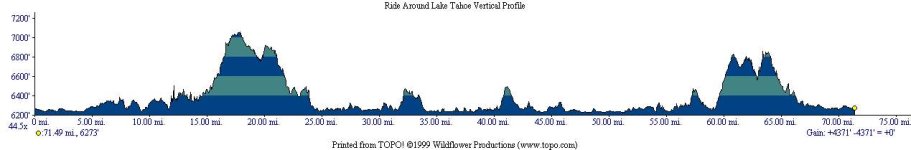

I'd like to build a bike for two purposes:
1) 72 miles around Lake Tahoe in under 3 hours, with minimal assistance. (Avg 24mph)
There's a bike race around the lake on September 11, 2016. So if I get it built before then I'd like to "race" for fun (maybe the day before or later start if I'm not welcome).
Code:
Distance            71.638 miles
Total Ascent        7591 feet
Lowest Point        6236 feet (at 5.76 miles)
Highest Point       7080 feet (at 62.97 miles)
Uphill              25.91 miles (36.2%)
Downhill            25.35 miles (35.4%)
Flat                20.37 miles (28.4%)
Max. Height Gain    843 feet
Steepest Uphill    +56.7% (at 61.63 miles)
Steepest Downhill  -40.0% (at 17.04 miles)
Longest Uphill      1.32 miles (at 58.51 miles)
Longest Downhill    1.21 miles (at 20.17 miles)
