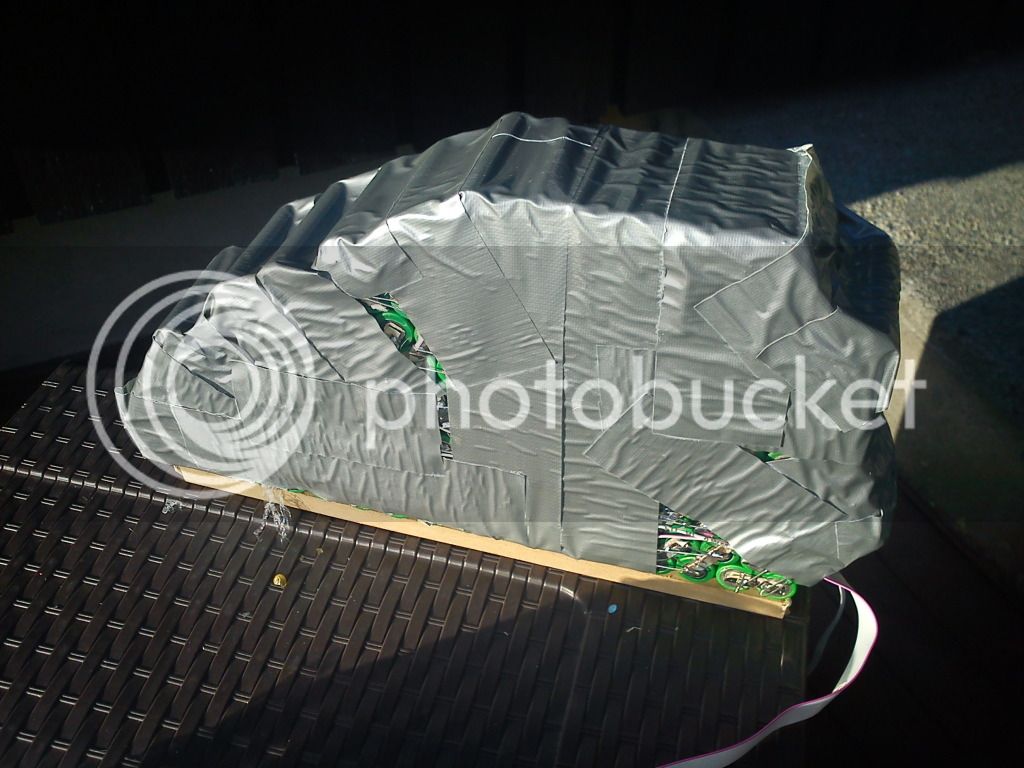

Progress on the stealth pack :D
Done fiberglassing
From the topside. It was hard to get out.
Looks like the styrene has dissolved my gaffa tape. Hope it gets it's act together :p
This is how it will mount on the bike, not bad for a 180 18650 cell pack.
Planning on using some cheap white matte paint on it.
Not quite sure how to mount it to the frame. Rubber mounts seems like the obvius choice, but I'm not sure how.

Looking cool! Can't wait to see it mounted up/painted etc. Give it as much shock absorption as you possibly can or you'll likely see solder joints popping off the second you hit big potholes or go off road. Ask me how I know. :wink: :mrgreen:
These strips of silicone are layered inbetween every second layer. The gaffa tape also keeps things tight. I hope it will help.
I'm planning on dressing the inside of the fiberglass pack with some high density foam (or more silicone). Actually I'm concidering using bathroom silicone to make my own rubber mounts xD. Velcro also seems like a possibillity, but given its 10-12 kg weight - I'm not so sure.
I used to use velcro with my duct tape strap packs and it worked pretty darn well actually. A little side to side swinging sometimes, but flexible enough that it withstood most abuse.
