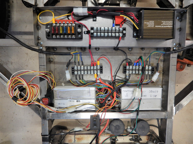

I want to have a 'battery on' warning light. I've looked throughout the internet and haven't found any of the common dash warning lights that are 48 volt powered.
Is there an option without having to install a second dc-dc converter to use lower volt lights?
I don't want to fire up the main converter just for one light.

If they use LEDs then all you need to do is put another series resistor with the light inside the switch / module, so that the current thru the LED stays the same. Dunno what resistor it has in there now, but current is typically a few mA per LED, perhaps a few dozen. You can use your multimeter to measure the current draw on it, set to 200mA and put the red and black leads on the A or mA hole and ground of the meter, then put the other end of the leads in series with the power to the LED.
We'll just say it's 10mA for a nice round number. So to get that for a "12v" system, they would use 12v / 10mA = 1.2kohm resistor. For 48v to get 10mA, you'd use 4.8kohm resistor. If you use it in series with the existing resistor, the currrent will be lower and the LED dimmer, if you want the same brightness as original you'd just subtract the original 1.2kohm from the 4.8kohm and use a 3.6kohm resistor. If you cant get the value you need, use the next higher one, not lower, cuz less current is better than more. ;)

While looking at how to wire in a 12-volt indicator light I found what looks to be an extra positive wire going to the IGN switch then to the converter. Not sure how it got there so not sure what its function is.
3 (red) positive wires where there are only 2 called for.
It's inside the green oval marked with yellow and red. To me, it isn't necessary.
Another thought. I'm thinking I can move the IGN switch to where it is marked in purple.
If I was to use a twelve-volt indicator light on the output wires (just ahead of the proposed new switch location) then I would as you mentioned, know if the converter is on.
Wouldn't this arrangement nullify the need for any added resistors?

Ok, I'm trying to clean this up. Think it's confusing? You should see it from behind my eyes, shock: whoa!!
Unless there is something incorrect I hope this can be the final draft.
Key to changes in diagram
#1 - The installation point for the 70 amp circuit breaker. Once the vehicle is completed and in drive mode, the main battery circuit breaker will be left on and this new breaker will be the primary on/off for power to the system.
#2 - The is where the key switch was originally positioned. Up to this point, I haven't used a key switch. I shunted the switch wires for both controllers and have been driving it that way with no known problems.
#3 - This is where I intend to wire in a 12-volt indicator light. The light provides a visual warning when the battery/system is left 'on'. My logic is, the power goes to the controllers and the converter via the breaker switch. The amount of time would normally be short. Not much reason to have this 'on' condition unless there was some intent to ready the vehicle for driving.
#4 - The new position for the key switch. The idea is that when needed the power would go directly to the controllers and converter via the new breaker but not past the key switch to the remaining system until the key is turned on.
I hope this helps to see what's-what, and any mistakes I may have made.
Thank you for helping, guys. I wouldn't be where I am without your help.

Yes, it's getting pretty complex there. I don't see anything that won't work.
The ignition switch is probably unnecessary at it will only turn on/off the 12v loads and won't keep someone from driving off with the car. You could switch the "ignition" lines going to the controllers. That would keep the motors from running but everything else could be turned on.
The relay may not be necessary depending on the amp rating of the headlight switch. Won't hurt to keep it as is.
It looks like you have the brake lights wired. Not sure why there's a ground connection to the brake light switch. I don't think it needs one. There is probably a way to make the brake switch also kill the motors. Normally this is a connection to ground to kill. Some controllers have a "high level" brake input that comes off the brake light wire and kills when voltage is present. This is optional.
Audio systems are generally under 5A. They usually have their own fuse inline with the 12v wire too. If you install a player, you can see what the fuse rating on it is and use something slightly larger.

Well after all the fuss about not finding the right type 48 volt indicator light, I found one today. It's on order and will be here ????? https://alpinetech.com/alpinetech-8mm-6v-12v-24v-48v-220v-120v-ac-dc-led-metal-indicator-pilot-light-lamp-wire-leads/
So with the 48 volt light, I can go back to plan 'A' and install the light so it shows when power is on with the new breaker. AND, I can move the IGN switch back to where it is supposed to be. I only shunted them for fab work anyway.
I received the new breaker (70A) and the new switches today. The switches are all lighted SPST @ 20A.
https://www.ebay.com/itm/252346785495?ssPageName=STRK%3AMEBIDX%3AIT&_trksid=p2060353.m2749.l2649
My headlights are 75/55 watts, assuming that means high and low beam wattage.
If I used the calculator correctly @ 75 watts, that will only be 1.56 amps per headlight X 2 = 3.12 amps
https://www.rapidtables.com/calc/electric/Watt_to_Amp_Calculator.html
Plus I can't find any amperage for the rear LED taillights. But they should be negligible I would think.
https://www.harborfreight.com/6-in-submersible-led-stopturn-trailer-tail-light-64327.html
So with 20A switches, there isn't any reason for using a relay for the headlights? I'm asking.
Now the instructions for the OOGA horn call for a 30A circuit and a relay. (Negative ground)
I have a 4-pin relay if needed.
https://manuals.harborfreight.com/manuals/96000-96999/96291.pdf (diagram on page 4)
And lastly, I removed the unnecessary ground going to the brake switch.

If they're 48v headlights, then yeah. No relay should be needed. Current will be four times higher if they're 12v.
If they draw the same power mine do (look similar, from amazon)
https://www.amazon.com/gp/product/B07T9DLSLM
https://www.amazon.com/gp/product/B07PKBZGCR
then it's way less than an amp per light even on brightest.
Note however that the "brake/signal" light isn't very much brighter than the "tail" light, so I used two sets of red, one for brake and one for tail, and the amber set for turn signals. (pic at end)
Horns are very current intensive especially at turn on. If your switch only does 20A it will work since it's only used momentarily but it will wear the switch and it *could* cause it to fail stuck on (probalby not, but it did happen to me once using a 10A switch and a couple of car horns on CrazyBike2).
If the relay has two pins for coil and two for relay, then you wire one relay and one coil wire to ground. Then wire the other coil wire to the switch to provide power to teh coil when you want the horn to honk. Then wire the other relay wire to one side of the horn. Then wire the other side of the horn to 12v power.
Don't know where my head was. They are (as shown in the wiring diagram) only 12-volt headlights.
So, using the calculator correctly with proper numbers, the result is.
12.5 amps (2 x 6.25 amps) plus tail light amps.
Again, correct me if I get this wrong. With 20 amp switches, I don't need to use a relay. Though I could if desired.

Today was truly electrifying
The first thing I did was get rid of the 70 amp breaker.
Last night I came up with a solution where I will be able to get to the battery breaker when needed.
We'll let that come as a surprise later on.
I was able to get everything wired as diagramed and nothing sparked or blew up.
Voltages check out for both @ 12.1V and 55.5V.
At the moment the only thing that seems to be controlled by the key switch wiring is the go-no-go part.
Had to toss the key switch that came with the motor kit. It's cheap and has come apart. I'll be looking for a better one.
Probably a 'barrel' key type. Right now I'm using a temporary on/off switch I have, from who knows where. But it is working.
I have done a (wheels up) run, check of the drive system, and all works as designed/desired.
Next, I believe is to run the wires for the remaining 12-volt accessories.
Starting with the wires to the toggle switches.
So it's been a good day. A productive day. A satisfying day... :D
