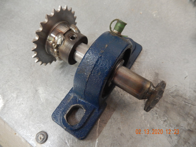

Hillhater said:Hi Ed,..looking very impressive !
I know you are obviously a skilled :lol: and experienced engineer/ :lol: designer :lol: /fabricator :lol: , so dont take these comments as anything other than friendly thought from an idle pair of hands. :wink:
Just a couple of thoughts to keep your mind ticking over between “tool time”
1) motor to axle drive train...i see no freewheels or sprags ? Hmmm, good point sir. The addtion of freewheels, will affect using reverse, I think.
With that reduction ratio, is it going to be hard work moving her manually without power. ? No, I'll have my wife pushing while I steer....JUST KIDDING![]()
2). That 3/4 axle ??...once you split it, i just wonder how much axle/chassis flex may interfere with those chain lines ?..since you are rolling with no suspension.I just split the axle today. At less than 25 mph, and on relatively smooth-ish paved roads, I'm not really anticipating any problems. BUT road testing will surely tell us more.
The only similar situation i can think of is race go karts, where they moved from 1” axles , up through 30 mm, 40mm, and even 50 mm, hollow toughened, axles to avoid axle flex and chain problems. I guess I need to watch out for pot holes.
Anyway ,..in your situation, i guess you can afford to try it first, and change it later if there are any issues !
....more power to your welder !![]()
Hillhater said:[ That 3/4 axle ??...once you split it, i just wonder how much axle/chassis flex may interfere with those chain lines ?..since you are rolling with no suspension.
