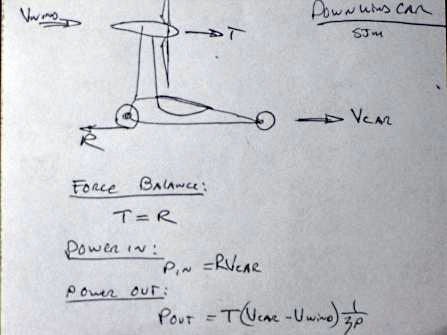

doctorGONZO said:
how a wind molecule having zero velocity relative to the car body, can possibly interact with the prop so as to push upon the prop resulting in a thrust FORWARD to push the car
Here the vectors for this situation.
As you see the force exerted by the air on the blade is doing positive work in the ground frame, so the air transmits energy to the car.
No one said anything about a sailboat or even a land yacht with typical sails being able to travel directly downwind faster than the wind. Whether you're simply a troll or you're just too closed minded to try to understand the mechanism, the result is the same.
FWIW, If the propeller was working like a wind turbine with the wind acting directly on it, then yes the limit would be wind speed. The prop is pitched like a wind turbine only to get it started, then the pitch of the blades is changed to a propeller where it behaves like a plane flying with the wind.
The craft is quite aerodynamic and has low rolling resistance, so traveling faster than the wind doesn't take very much power at all. Look at the swept area of that prop and it's easy to see that there's enough energy available in the wind to do it. A common sail won't work, so a new way to harness and use it was required.
Stop being so stubborn and open your mind enough to let a new idea percolate. You seem intelligent enough with adequate knowledge in the subject matter, so while it's preventing you from seeing it so far, there's no reason you shouldn't be able to grasp it once you look at it in the correct manner.

endlessplane said:
doctorGONZO said:
endlessplane said:
Yes, the car travels directly downwind. But the car has moving parts, which don't move directly downwind. As shown in the top left picture:
But thay dont explain SQUAT.
If you have problems understanding vectors and velocity addition look it up:
http://en.wikipedia.org/wiki/Velocity-addition_formula#Galilean_addition_of_velocities
http://en.wikibooks.org/wiki/A-level_Physics_(Advancing_Physics)/Vectors#Vector_Addition
doctorGONZO said:
"Show me the specific path that a unity of energy takes starting with a molecule of wind and how it winds up moving the car faster than the wind"
See diagram above. The velocity of the blade (in the ground reference frame) and the force of the air on the blade are at less than 90° to each other. So the air is doing positive work on the blade (transferring energy to it), in accordance with the dot product of force and velocity:
http://en.wikipedia.org/wiki/Dot_product
http://en.wikipedia.org/wiki/Power_(physics)#Mechanical_power
If you want a more general explanation of the power flow, look up the exam solution on page 12 of this PDF:
http://www.aapt.org/physicsteam/2013/upload/E3-1-7-solutions.pdf

7circle said:
BUT what about the work from the wheels driving the prop' ?
Project "blade force" on "tangential blade velocity". As you see this tangential blade force opposes the tangential movement of the blade, so it needs the be balanced by an equal/opposite force from the wheels. The product of that tangential force from the wheels and the tangential blade velocity represents the power transmitted from the wheels
7circle said:
How does this translate through the torque vector?
In this "unrolled" diagram torques correspond to tangential forces (perpendicular to "vehicle velocity").
7circle said:
Is it defining the remaining component of the propellor force vector?
No, the decomposition of the "blade force" into forwards thrust and torque is not shown, but you can easily picture it as explained above.
7circle said:
Also the work done by the "unconstrained force" vector for a distance travelled on the helical path would be more than just the displacement in the vehical motion.
Not sure how you can compare work with displacement. But yes, the blade sections travel more distance than the car body, if that's what you mean.
7circle said:
Any clarification of the balance of power between wheels and prop would help.
I hope the first answer above does it, if not ask more specific question.
7circle said:
Say some way to define the chain tension.
The transmitted power is relevant. Chain tension is then just a function of sprocket sizes.
7circle said:
What changes in the air dynamics to wash behind the cart?
Mainly speed. The propeller speeds up the air relative to the car, but slows it down relative to the ground.

So in pic I have drawn on the forces that keep the blade on the helical path.
The right to left component is applied by torque from the chain.
The top to bottom component is applied on the thrust bearing of propeller axel.
This loading force comes up from the wheel axel bearings.
This causing the torque input to the transmission.
This links the helical path to the transmission function.
Assuming minimal loss.
