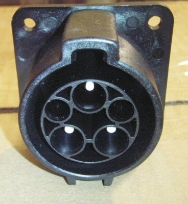

Doc
I might also add a J1772 plug to the bike :mrgreen:
This would become one of the first ebike to gavce integrated J1772 port for Level II electric car charging speed! 8)
http://modularevpower.com/
1.25 hours charging speed !!
Doc
haha that is a big connector, a bit overkill? :)

Well I have a Volt already so i have a Level II charge station but the goal is to be able to charge very quickly using any level II charge station availlable!
