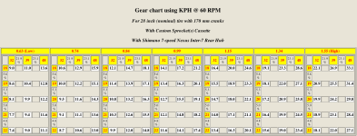

I am going to play with the calculator now and see what sort of motor RPM you currently get, assuming cruise speeds of about ...what 40 to 50 kph? max sort of speed, average of around 30-40 and hill climbing a bit less?

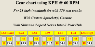

This is your current setup
Hub ratios across the top
This is with the chain on 48 at the front
18 being the rear sprocket size on the hub
The rpm figure is the rpm of your pedals. I went with 60 rpm to give speeds (along bottom in white), of what I considered you may be riding at.
That gives motor sprocket rpm of 206rpm at constant pedal speed of 60 rpm (EDIT with data from later on about 5:1 motor g/box, this gives motor rpm of about 1030)

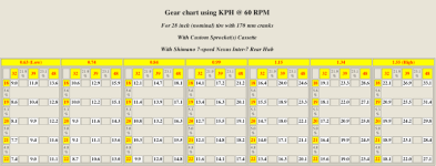

You say that using the 32 ring on the front is too fast pedal speed..but if you did that gives motor sprocket rpm of 308rpm at constant pedal speed of 90 rpm
EDIT with data from later on about 5:1 motor g/box, this gives motor rpm of about 1540
That would be this
Not sure what the best speed to run these motors at is? Anyone? OK so max is 4500. To get anywhere near that is going to require a big leap in gear ratios from motor to crank, but motor to crank chain sets to do that are not available in these sort of ratios from Cyclone, so one can only assume that Cyclone are not expecting the motors to be run often at those max RPM figures.

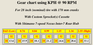

here is another set of calcs, at 60 rpm, pedal speed (cadence) that would show the speeds you would get if you changed the rear sprocket, and also included is the speeds you would get if you put a 39 tooth ring in in place of the 32.
The calculator does not work the other way so you an put in speeds and see what pedal RPM you get, so you will have to do a load of calcs yourself to get pedal rpms you feel comfortable with.
