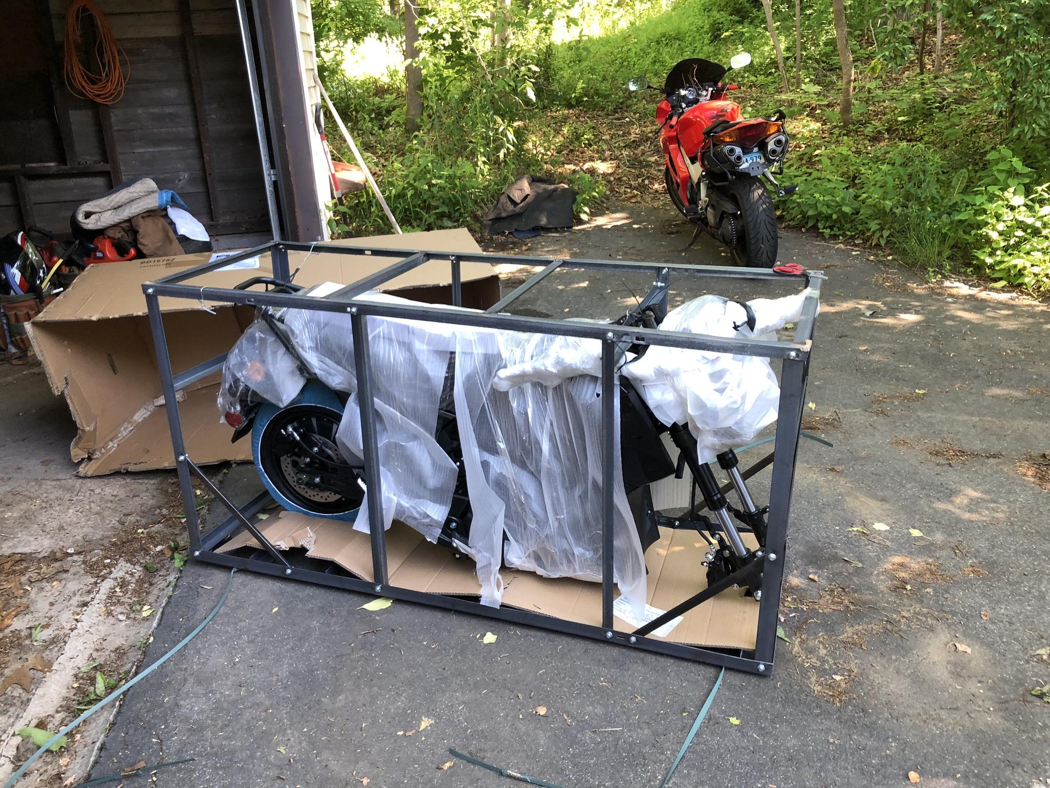

Hey all-
Been lurking here since May when I ordered my E Grom from Belmonte Bikes. Since it arrived, I have done a few upgrades but have a ways to go. I will share my progress here and solicit any suggestions. Thanks in advance, this is a forum full of interesting projects!

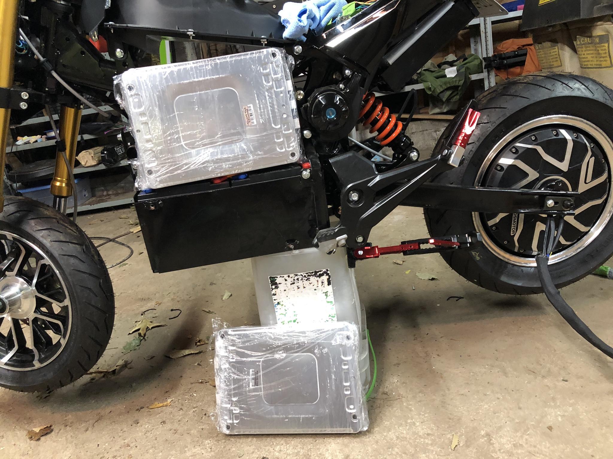

11 Nissan Leaf batteries (not installed yet)
80 amp Greentime controller (not installed yet)

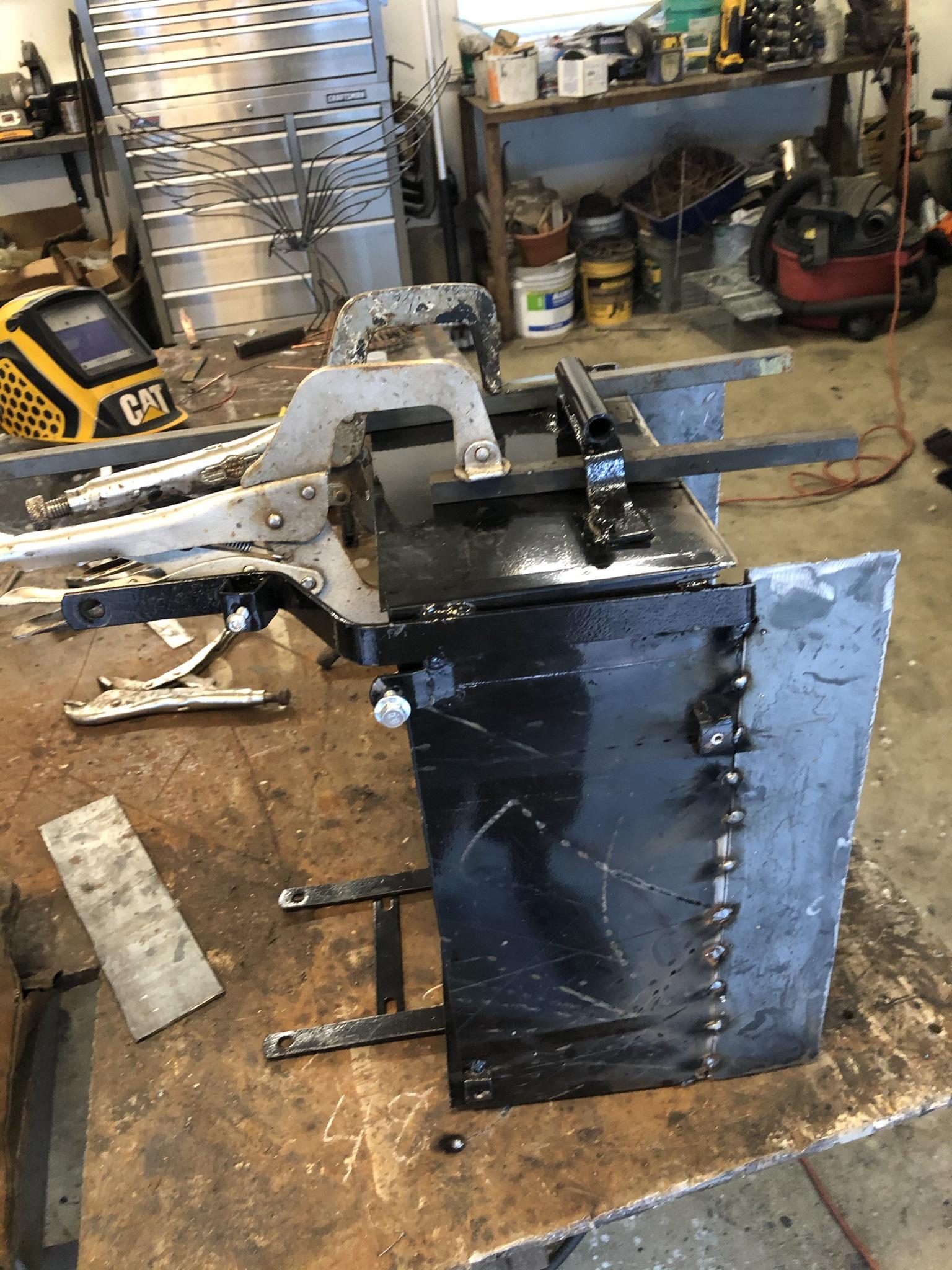

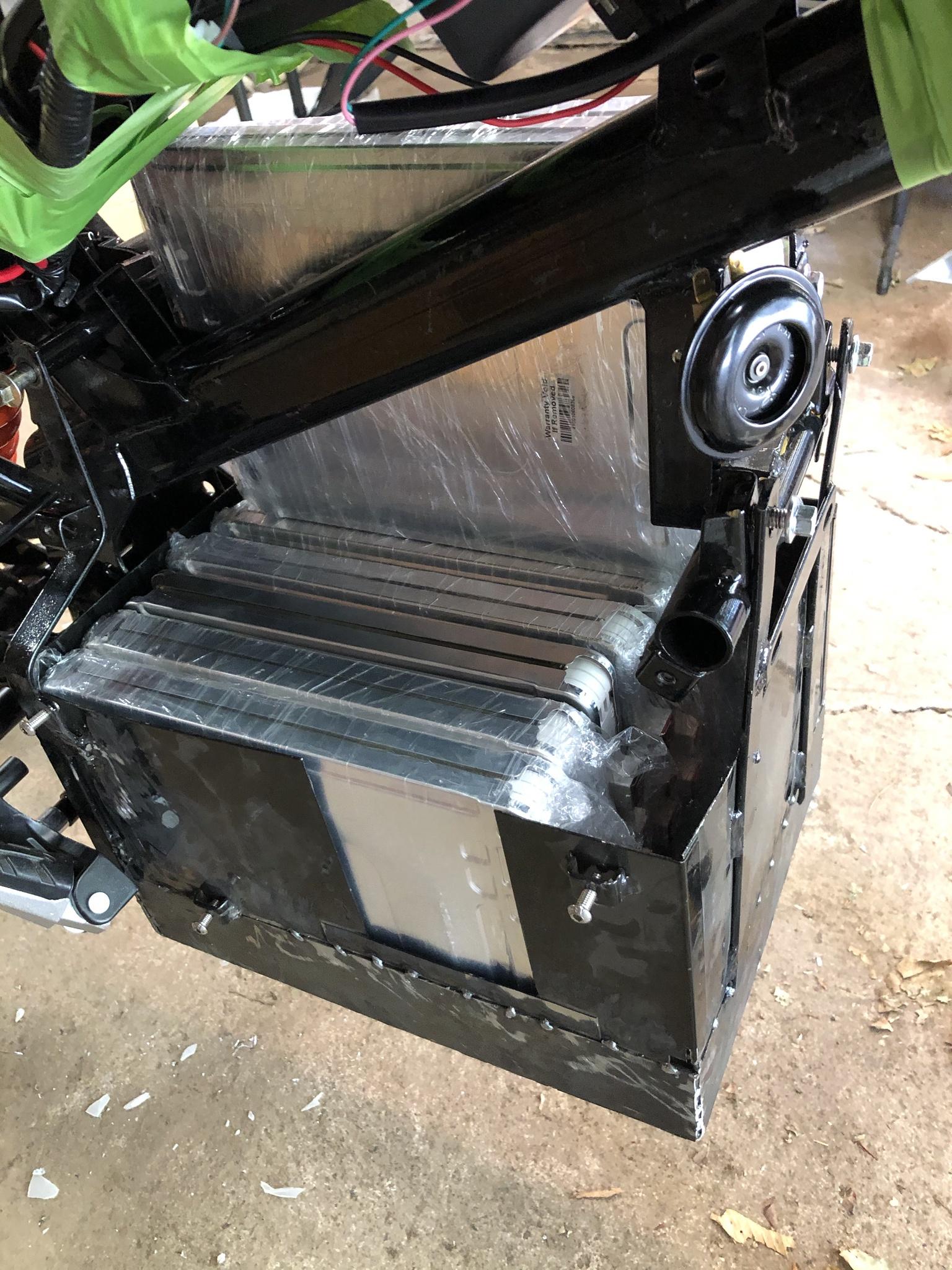

So I dropped the battery box, cut the bottom out and added 2-5/8" to the bottom edge and rewelded the bottom. The steel was so thin, we couldn't get a good bead so I settled for buttons every few inches. I will mount this and the wheels and make sure the bodywork fits and the ground clearance is at least workable.
Then probably JB weld outside/Silicone inside and Paint. Very little of it is visible but the button welds look like crap.
I was pleasantly surprised that 7 cells fit across the bottom. All 11 will fit nicely as long as the ground clearance is ok.
Needed thin plate steel and so this is how we cut it!

Nissan Leaf cells need a bit of compression to get the most out of them and prevent them from swelling. Do you have all of the Nissan hardware that help you achieve even compression using bolts through the holes at the 4 corners without deforming the cans? Look up a pack teardown video to get an idea of what you need.
John-
That is a good point and one I didn't know about. Thanks! I was thinking of using threaded rod in the four corner holes. Now I definitely will. 4 of the cells will be used in two sets, so I will probably bolt those together but they won't have much compression. These are standing up on either side of the frame. The ones in the bottom of the Battery tray are squeezed to make 7 fit. I can run with 6 there and make room for endplates, or stuff 7 in and a small bit of foam and should have good compression.

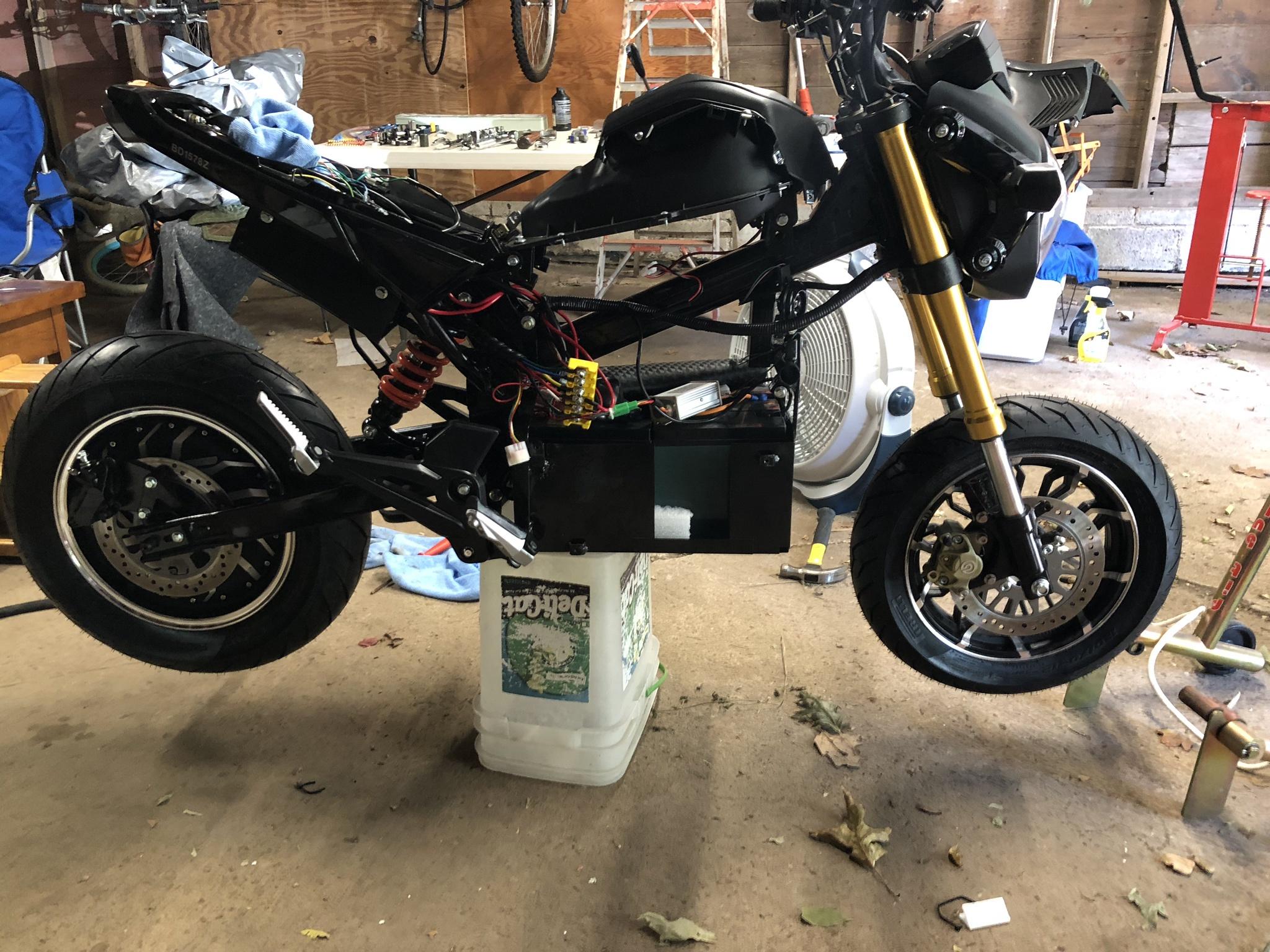

Much appreciated! Keep the suggestions coming all. Finally have a Kelly KLS S and the battery box mod and the motor mounted, it is almost time for a test ride!
