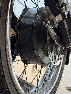

For all the adjustability Grin built into their torque arm frame clamp, this weird frame does not want you to use it. A 'seat stay' meets the chain stay right where the frame clamp wants to rest, and the bead of weld around it blocks the path of any hose clamps.
So, I put the frame clamp on backwards. Working around the brake caliper post mount, I got one hose clamp fully on the frame clamp, and one extra heavy zip tie (175 lb. tensile strength, more flexible than hose clamp) halfway onto the other end of the frame clamp. As a backstop, I put another XL zip tie around the torque arm and chainstay. This is not a good long-term solution as UV and fatigue breaks down the plastic in zip ties, but for the moment it is a solid mount, and avoids the forbidden lateral forces on the torque arm.
chuyskywalker here found their RadRunner Plus has a 175 mm dropout width, and machined some custom Max45 axle adapters for this instead of flexing the frame. I would have just flexed my frame as a 2.5 mm deflection at each dropout seems minor. But my non-Plus RadRunner has only 170 mm between the dropouts, so that wasn't necessary. The 170 mm slotted dropout axle adapters fit the frame perfectly.
I installed a Shimano disc rotor that appeared to barely clear the motor cable, or perhaps touched it only slightly. Unfortunately "only slightly" was still too much. In the course of testing the bike (spinning the wheel in the air and riding it around the block), the innermost part of the brake disc wore a groove in the outer sheath of the motor cable, exposing a bit of insulation from the wires inside. Oopsie!
Fortunately I see no exposed conductor, so I don't think it's worth the trouble to replace the motor cable. Grin sells discs that are supposed to clear the cable, but I ended up removing the rotor entirely, and riding for a week with only regenerative braking on the rear wheel. It was still enough to skid the wheel on wet pavement.
Eventually I hand-filed away some material from the rotor and re-installed it on the bike. I also happened to have some Shimano rotor bolts with a ~1 mm smaller diameter head than the Grin-provided bolts. (It seems, from the wear pattern on the motor cable, that those bolt heads also slightly interfered?)
The problem appears solved now.

Build Notes: Motor
