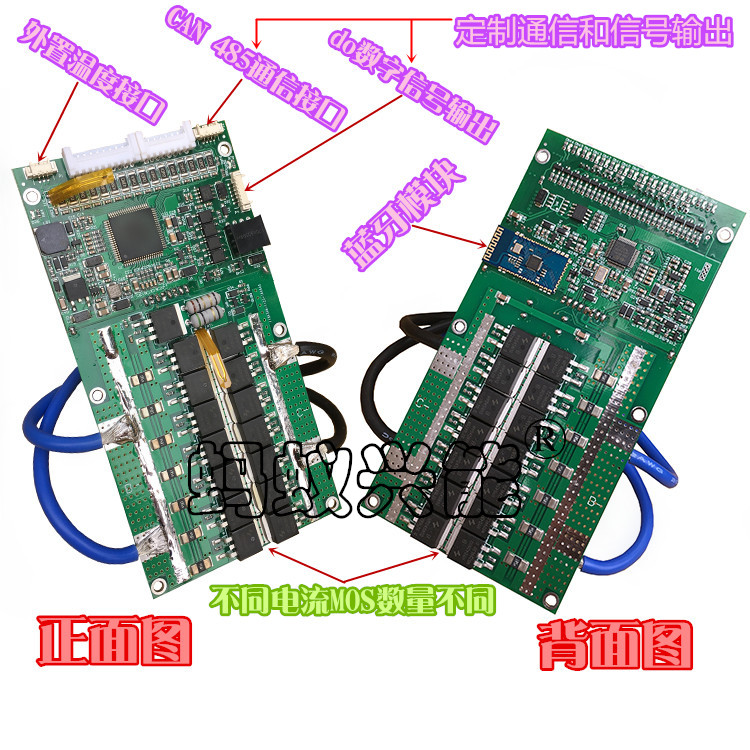

To get my point across more concisely, I will show the schematic for a common, cheap and dangerous li-ion BMS. This design is used in the infamous, fire-prone :flame: hoverboard batteries: View attachment 1
This is a very unsafe design for 3 reasons:
1. Each of the protection chips (DW01A) is separate, there is no cooperation. Meaning: one chip could fail, due to ESD, water droplet, etc. Then that cell group is completely unprotected, opening up the possibility that the cell group could become overcharged and explode unexpectedly! With a 2-wire monolithic design, if one part fails, due to ESD, etc, the output FETs are turned off PERMANENTLY. This is much safer, as charge can no longer flow in or out. Crisis averted, while also alerting the user of the failure.
2. For exactly this reason, the manufacturer states clearly that the DW01 is a 1S ONLY protection chip. Using them as a 4S, 10S, 14S, etc is NOT RECOMMENDED because of this safety hazard! That's what the "01" in DW01 stands for! Here is the datasheet confirming my claim: http://www.kexin.com.cn/pdf/DW01.PDF
3. The protection and balancing chips are separate, leading to a condition where the balance chip fails, and the cell group is no longer able to bleed overcharge anymore. This is less dangerous, but still a design flaw stemming from using a 1S protection chip incorrectly. Proper multi-cell chips will perform balancing as well as protection.
Here's an example of an e-bike BMS using the exact same design but extended to 10S. I've seen clones of this circuit expanded to 13S, 14S even 20S, and are as cheap and abundant as they are unsafe.
DO NOT risk them. Buy a proper, high quality 2-wire BMS with a monolithic multi-cell IC. They cost more, but are are 1000x safer and cheaper than a fire!

Can you please review some BMS that is affordable but you find good? How about the ANT BMS?

The ANT BMS looks very nice, functionality wise. I can't get a good look at the internals, but it's a 2-wire, which is a good sign. The ultra-cheap fire hazard BMS boards are almost exclusively 3-wire. (not to say that ALL 3-wire units are bad)
Unfortunately, the affordable BMS units have little-to-no built-in ESD protection. I've yet to see one that meets IEC-60004-2 level 1 standards or even any mention of ESD safety. The best ESD prevention is to use an ESD wrist-strap attached to a solid ground point when handling the BMS. A quality ground point like the outer case of an ATX PSU, a microwave (or any 3-prong appliance).

Yeah, it is hard to find good pictures really close to ANT BMS. There is some picture, but it is quite bad too. You cannot see what components they used etc.
Nice find! From the pic, I believe it's a clone of this (much clearer photos): https://imgur.com/a/DZ9X4tx

Could you give an example of a proper way for a 2S or 3S bms to be built, and then have the ability to put multiples together and still have the same safety factor.
Of course, there's 2 ways to go about it.
The best way to build a modular system like that, is to use a chip that was designed to be "stackable". The chips will directly communicate to its above and below neighbors, so if one chip is dead/faulty, the entire output is shut off.
Daisy-chainable BMS chips are not very common though. The only options I can find are from TI, and there's only 4 of them, the minimum in each stack is 3.
http://www.ti.com/power-management/battery-management/protectors/products.html#p2192=Stackable%20(built-in%20interface)
Alternatively, use individually protected cells. This is more expensive and less efficient than the above method, but it is definitely safe. Essentially each cell has its own pair of FETs and 1S IC (how the DW01 is supposed to be used).
These 1S DW01 and similar ICs are made to go into phones and flashlights that will only ever have 1S connections. They're specifically made to interface to a single cell's N-channel FETs directly, not to PNPs in a daisy chain configuration.
The PNPs are "active low" devices, so when the output of the DW01 is high (no OVP or UVP triggered) the PNPs are allowing current to flow, turning the FETs at the bottom on. If there is an OVP or UVP, the DW01 pulls the base of the PNP low, blocking the current and turning off the FETs. The hazard lies that if one DW01 is damaged, the corresponding PNPs will not block the current, which will allow the cells to overcharge/undercharge.
By comparison the N-channel FETs are "active high", so if the DW01 is damaged, it works like a dead-man's switch. The FETs shut off, regardless if OVP or UVP conditions are present.

I agree, not much point in going modular on an ebike BMS. A single 10-14S BMS is ideal for most ebikes.
john61ct said:
Not sure why 2S or 3S units would be particularly advantageous?
The advantages of using a >1S system I see:
1. Less voltage drop than a protection circuit with separate shunt resistors + 2 FETs in series on each cell.
For example, you'll never see a protected 18650 that can come close to a unprotected 25R or VT6, because of the resistance of the shunt and protection FETs. The daisy chain configuration only has a single shunt, a single set of FETs at the bottom of the stack. In theory you could create a 1S protection circuit that can match the performance of this but it'd be very expensive and impractical for high currents. Not to mention the losses of the shunt could be mitigated by using a single hall-effect current sensor with the daisy-chain configuration.
2. Error communication, and adjustment of the balance/protection voltages through a host MCU. Granted this feature is not implemented in TI's small 3-6S chips, but Linear/Analog implement it in their larger grid-storage/electric car BMS designs.
