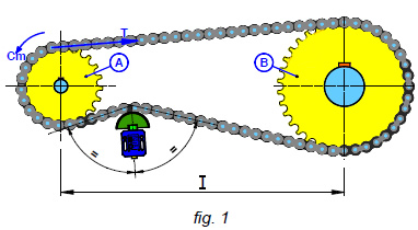

When a small diameter drive sprocket is feeding a large diameter driven sprocket, chain wrap becomes a concern - this is especially problematic when high wattage motors are used. It is best to avoid exceeding 8:1 ratio when the shafts are close to each other. Beyond this, the practicality of such large ratios can be limited due to power loss and excessive wear on the 9t drive sprocket. If a greater reduction is needed, multiple reduction stages (compound gearing) are suggested. Yes, idler(s) can be employed, but reality is, you shouldn't be running a 9t drive sprocket to begin with... for reasons previously mentioned.

Anybody have a suggestion for how to lower my gear ratio? Do I simply need a larger front sprocket and smaller rear one?
No, it's the opposite, but you can't realistically go any smaller on the front. In fact, 9t is already suboptimal in terms of chain drive mechanics (reliability, durability, noise, etc.).

Ooo ok wow, yea I see how smaller in front is a no go. The rear is maybe still a possibility tho. Otherwise seems I’ll have to add a third or fourth sprocket with another chain
Sounds like they are suggesting a jack shaft idea, take the motor to a medium shaft with say a 12/24 sprockets to reduce speed then you can use a different sprocket off the same shaft to drive the wheel. Yeah it's gonna affect range and noise a bit, but it enables more reasonable ratios because they would multiple together

Here is an example image for a method to increase chain wrap on the smaller sprocket.
This image shows a rubbing block but a idler sprocket with bearing would be better.
A bigger rear sprocket with the correct bolt pattern to fit your hub may need to be custom made.
It's possible buy a sprocket "blank" then use the existing sprocket as a drilling template to make your own.

#35 sprockets exist up to at least 85t, if you can tolerate the noise and chain wear from the 9t you might be able to make your single stage work. I think I would

It will not. The ratio will be determined entirely by the size of the input sprocket (pulley) diameter and the output sprocket (pulley) diameter.
It may be true that a shorter chain link would permit a smaller diameter due to the mechanics of cutting sprockets, and that this then permits a different ratio, but apart from that, the chain pitch has no input

Of course the chain size doesn’t directly affect the ratio but enables a bigger size difference between the sprockets which is what you need. You can get a lot more teeth on the rear for the same diameter and on the front you could keep the same amount of teeth or leave it the same diameter, having more teeth, which wouldn’t help the ratio but has benefits listed above
Here's your current ratio (based on estimated loaded RPM):
And a 'ballpark' estimate what it likely should be for single stage reduction:
Ratio 14 to 1. (which requires a driven sprocket of 126 teeth.
