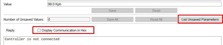

Previously too on the Dev Screen all the communication between the controller and software was being shown in HEX format, while now we have it showing all the read data in parsed into english instead and then you can choose the hex view if you want.
It also gives an option to highlight and display all of the unsaved variables. This can be especially handy when you are loading on a new settings file over an existing phaserunner/baserunner since you can see a list of exactly what parameters are going to be changed if you save the settings.
