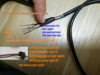

Is it possible to connect a PAS Sensor and possibly throttle to a LSW17288-2-1E that's wired for torque?
I was hoping to trace the wires to the PCB and potentially change some pin-assignment in GitHub - EBiCS/EBiCS_Firmware: Free FOC firmware for Lishui E-Bike-Controllers, but it's very potted inside.
Torque sensor measurements:
Red: ~14V
Green: 3.3V
Black: GND
Yellow: 3.3V
White: 0V
I just noticed the green pin for the torque is called "TA" which is the same as my original controller.
Should I just be able to find a 5V source for the PAS sensor and then wire the signal pin to the green pin of the torque connector?
Does anybody know what the ADI pin should mean?
How would I wire the throttle?
