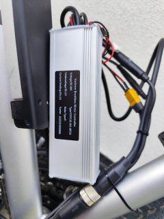

Hey guys, quick update—finally got this sorted out!
Ended up ordering a complete 30A, 1000W setup kit from Ali:
and it was pretty much plug & play. What I ended up doing:
- Swapped out the throttle and display for the ones that came with the kit.
- Kept my original Varstorm power wiring and PAS sensor—they plugged right in with zero issues
- Ditched the brake sensors entirely. All that cable clutter on the bars was driving me nuts from day one anyway.
What I love about the KT controller is how the PAS actually works now. Instead of blasting full power until you hit the speed cap for a given level, it delivers a constant level of assistance regardless of how fast you're going. Switching to a higher PAS level just gives you more push/power, but it stays consistent across the whole speed range. The KT controller also allowse to wire up a hidden switch/button to toggle a legal street-mode on the fly.
Even though the display I picked doesn't show live wattage, the bike definitely feels way punchier than the stock Varstorm setup, even though they're rated for the exact same amps/power.
Anyway, just wanted to leave this here in case anyone else is struggling with a similar Varstorm conversion.
