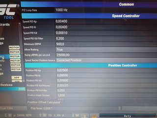

I finished the battery and finished the wiring. I tested everything on the bench and the bms would close the contactor when I pressed the power button. So I installed the battery in the bike and when I powered on the bms I saw smoke comming out of the battery and the bms is dead again. I removed it from the battery and plugged the battery directly to the controller to test the bike and it is slow like very slow. And the motor jerk back and fort before spinning. and when it get going at like 20mph it start cutting out.IMG_2945.jpegIMG_2946.jpeg

that’s strange the motor is jerking and cutting out. It almost sounds like something non-battery related although somethings not right with the battery since it burned up the BMS. It almost sounds like the phase wires are not the right combination, just a thought. I truly hope you get this sorted out, my friend! I know this is got to be aggravating.
Sounds like you have some problems with setting vesc up.
Maybe send some pics of what settings u have, maybe we can help. The jerking on startup sounds like ur running it sensorless mode. And check fualt codes.

That is what I tough too for the jerking but I redid the motor detection 4 times and it still does.

This is my first time using vesc, I only setted up an asi bac8000 before. here are my setting:

Running detection on the PC or app shouldn't make any difference but detection isn't always perfect and sometimes yields different results so running it a few times and averaging can help. That and make sure the detection current is roughly in line with your motor's size, so like running a very low detection current on such a large motor won't yield good results. If I recall you want like 10% of your target max current or something like that.
Also based on those screenshots the motor has an encoder so I believe there is an encoder detect that works the same way as the hall detect and is probably done along with the whole motor setup detection so rerunning the detection may sort that out if the encoder timing is off.

I did the encoder detect but not sure if it is right or not.
There are some differences between your numbers and mine. I have 2,8mohm resistance, 64,65uH inductance and 29,04uH in Ld-Lq difference. There are other differences too, I have some pictures I can post in the evening.

At first I did the motor detection like the 3shul video then the last few time I did it with the base vesc tool setting. I never get the same value exact value. I will try like scianiac said and do it wih 10% of max amp. Maybe there is a problem with the encoder setting.

What current/power setting where you using for the previous detection modes? In my tuning I did the detection at a few different power levels and did see a bit of a trend of some values changing with higher detection current levels while some didn't much. And then if I recall I used the results from the higher test currents. I don't recall if 10% is the exact value I heard but you get the idea, using 1% of your target current is not going to get good results and same with 50% probably so you want something that can give the controller some real feedback but not a crazy amount.
Using the logging tools on the computer program also can help, I think there is a section that will show motor rotor angle so if you find that and spin the motor by hand you should see the position change nice and smooth from the encoder, same when running.
