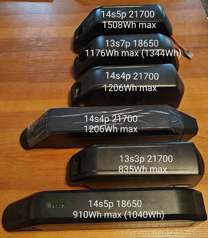

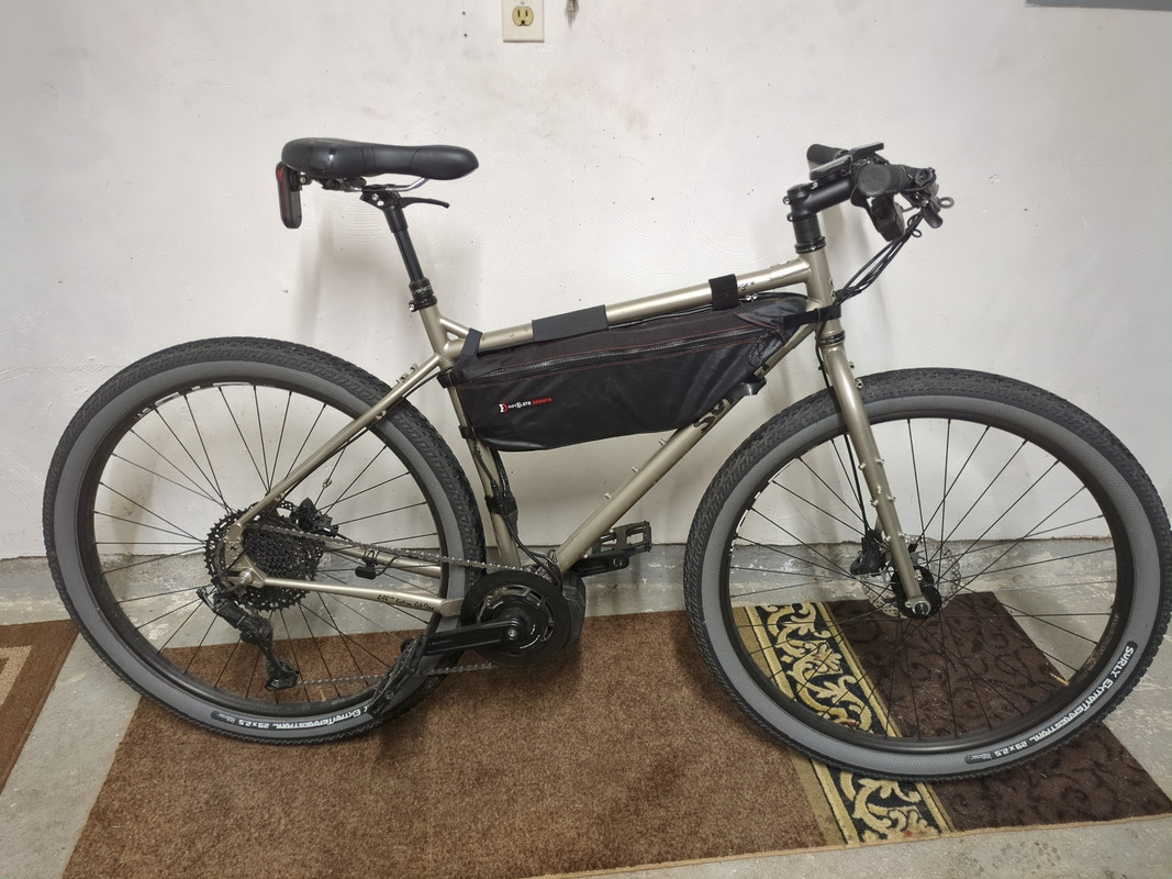

Pretty sure literally none of those will fit in my frame.Is there any good reason why you guys preffer those hanging bags for batteries instead of this
Many decent modern mountain bikes have very low standover height and are designed to accept long dropper posts, and may additionally have very short or nonexistent head tubes.Is there any good reason why you guys preffer those hanging bags for batteries instead of this
