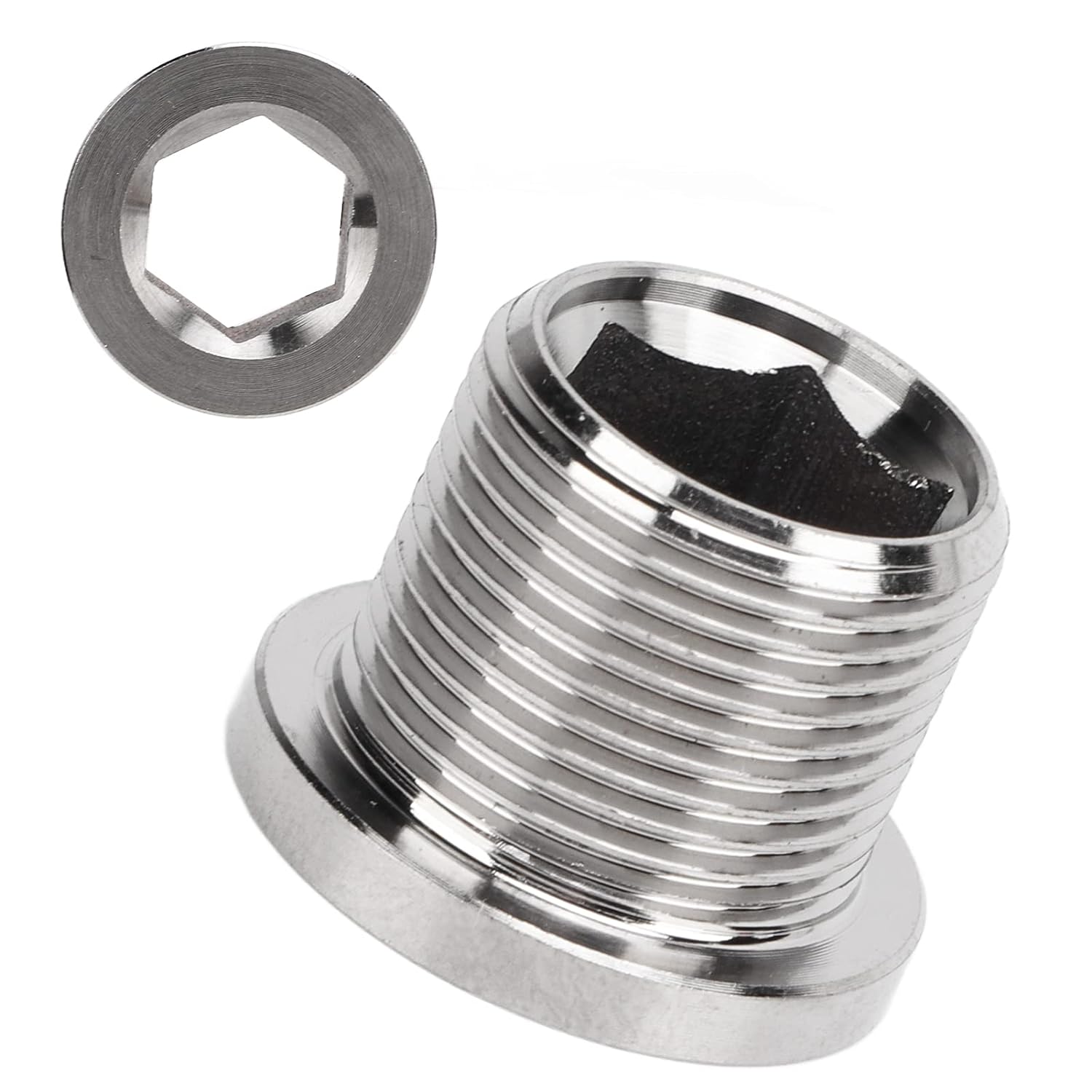

For a crank bolt alternative, I'm trying out some hollow ones on one Photon build:
It takes a 10mm tool, and I use a long "L" hex key to get leverage - so far, so good, has stayed tight, and the tool doesn't slip or pop like can happen with the stock caps.
Where from? Did they include the washer?

Amazon, IIRC - some come with washers, these did not. I applied a dab of blue Loctite.
The washer is part of the ISIS spec, BTW. They are actually very important - both as to size and thickness, but also that they need decent lubrication during assembly. Lubricating the washer might also help to prevent any movement in the interface to be transmitted back through to loosen the bolt.
