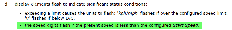

The problem is clear in the first few seconds of the video. Thanks for posting it - it got us to the answer quickly.
Here's a quote from page 9 of the Guide:
From your video:

teklektik said:
Spot on Neil. The Guide is very careful about only setting a small set of vital parameters so extra settings don't upset things. Because of interactions, diagnosing erroneous settings can be daunting for the novice CA user. It's a wonderful device but it can be vexing....
From your video:
:D
Thank you very much :!: :!:
That was one of the things i changed finaly cause i was desperate :cry: but i have changed again to 0.00 km/h... it does not flash anymore but i does not work either :cry: :cry: :cry:
There must be another error :(
