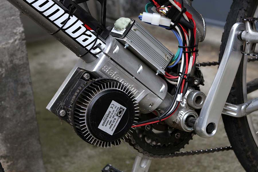

After 3500/4000 km of ride almost overvolted, today I checked the planetary "crappy" gearbox of my Cyclone engine.
The gears still in very good condition, I simply cleaned up the gear and replaced the greease with the new one. I think that they will work for at least another 2500km without need the substitution.
In the photo you have the teeth are very worn out and pointy compared to new, they have also lost their ramp on the tooth profile hence i imagine it would be very noisy now and not much life left in them, if you had run them in an oil bath like AFT they would have lasted a lot longer. Also all those wear filings have being going into the steel bearings so they would have some consequential wear on them also compared to the AFT where they put magnets to suck up the fillings from the oil to stop going to the harder ceramic bearings they would have lasted longer as well. And yes you get what you pay for as you said and thats cheap wont last long.... .

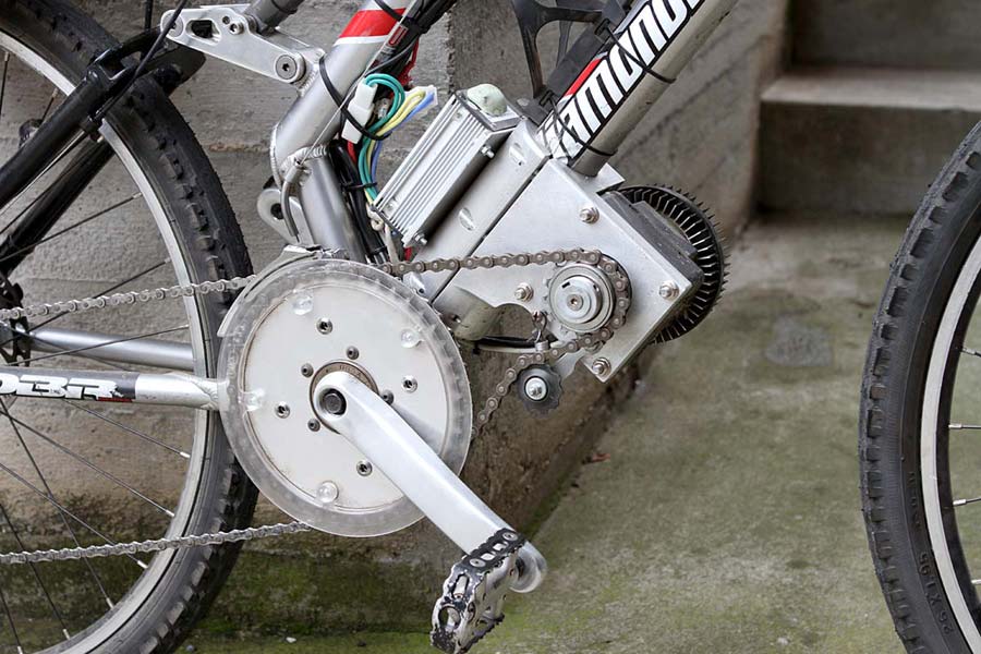

My first attempt (and terrible-looking) for upgrading Cyclone bracket to someting strong is to build only one bracket fixed in tree point: bottom bracket, vertical frame tube and oblique frame.
I build some rudimental CAD design, here some pictures
Today I cut and drilled a 20x30cm aluminium 6cm plate. The following are the result, I used only a drill and a saw with blade for aluminium ( working aluminium with correct tools is quite similar to work strong wood).
As you can see in the following pictures, it is only a concept but can be a starting point to made something better!
The problem is fixing the bracket on the bike frame, without drilling holes on bike, maybe the halfclamp can help.
I used only stainless steal or aluminium.
I cut 2 holes on the plate 35 mm for bottom bracket and 50 mm for engine. I could have cut the plate about 2 cm under the bottom bracket hole, but I preferred to kept it to provide a strong protection for the crankset.
It appended twice that I have hitted the crankset with rocks bending the engine cog, I had to use a rock as hammer to straighten the cog (MacGyver sucks!)
After fixing the plate on the frame, the engine on the plate and the crankset on the bike, I rest....
Yes i kinda messed up the "painting".

In the photo you have the teeth are very worn out and pointy compared to new, they have also lost their ramp on the tooth profile hence i imagine it would be very noisy now and not much life left in them, if you had run them in an oil bath like AFT they would have lasted a lot longer. Also all those wear filings have being going into the steel bearings so they would have some consequential wear on them also compared to the AFT where they put magnets to suck up the fillings from the oil to stop going to the harder ceramic bearings they would have lasted longer as well. And yes you get what you pay for as you said and that cheap wont last long.... .
Hi Nathan, I will try to use this gears until the end (after that we will known how long they last).
When I will replace gears I want to convert it in an oil bath gearbox. A Guy in this forum do it simply sealing the gearbox with a specific tube silant.
checking the rubber seals of the engine shaft and the gearbox axale, the seems already oil proof.
Regarding ceramic bearings, I think that they are completely useless. Any 2 or 4 strokes engine work with standard stainless steal bearings, also in my 30 years old Fantic trial I never need to replace the stainless bearings!

The test of my custom Cyclone bracket ("the costume plate")
This improvement make the quality of ride better.
- The engine chain is perfectly aligned
- No more vibration and crunches caused by the flex of the bracket
- Better cooling due to the removal of secondary engine bracket
- No transmission chain slip, there is no space between the crankset and the costume plate for the chain to slip out
Today I tested my new improvement in a mountain trail, half off-road and half single track.
Here some reference data:
- I drained all my two battery (one 48v 5A,one 60v 10A)
- Engine transmission: 13t engine > 48t crankset
- Bike transmission 32t front > 36t rear
- Total elevation 937 m
- Total distance 18.68 km
- Avg speed total trip 15 km/h
- Avg speed uphill on off-road 20 km/h
- Engine became worm but not hot (outside we have 5°C)
