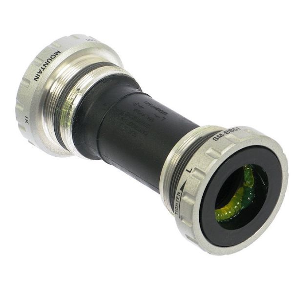

But your great bike unfortunately do not have BSA mount for bottom brackets, is for pf30 maybe. How do you think to put the Cyclone entended ISIS or Squared type brackets on the frame?

Currently I have Shimano cups.
This system is compatible with the isis Cyclon?
Thanks for your information.
I'am afraid that it is not compatible with cyclone bottom brackets.
Check the diameter of the hole in the frame where you need to fix the bottom brackets, it must be 34 mm. It also need to be threaded
To be sure you may ask directly to Cyclone.
I am searching good enduro bike good for Cyclone, until now only bsa (squared type) or octalink spline ( isis ) seems to be compatible.
