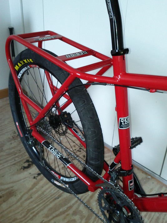

Ya. The back end narrowing into the seat post is an odd feature. I wonder why they went with that design? You can't fabricate an aluminum (or steel) triangle shimmy with a curved recess to accept the tubing. Then drill a hole for the plate to bolt onto...
edit: Looking at the design logic frame again and it's not a tube where your plate will go. More like a "flat bar". Washers hopefully will do it. Good luck!
neptronix said:
It's as if the frame is really designed around that staton gearbox and nothing else. No other scenario will really work.
Yea I was looking at their web page and how it only advertises the bike for a ice motor drop in. Yet the guy is on here advertising his bike as well
when only a hub motor will work.. It looks like an awesome bike , but id just think you'd want to make some adjustments for both camps to increase
sales potential. then again what do I know.. enjoying following this thread at least.
Right - it doesn't make sense at all to taper it like this. Panniers won't even sit right on the back end.
If this flaw was corrected, and the mounting bars were 100% straight, then this would be the most kick ass frame for our use. It would be stronger than the yuba mundo and capable of carrying some serious battery loads. With this frame, i am really not sure how to mount batteries and mounting the motor is still in the air.
It looks like design logic figured this out later on when they redesigned 'da trail'. I have tried to convince the designer to change things for our use.

This thing was designed to be easy to fab - a one-trick IC pony.
The Mundo has its own bit of weirdness and solutions to mid-drive seem to have used the familiar subframe - like the Urban Commuter mid-drive assembly.
Looking for a tool-light solution, I'm wondering if you can salvage your Bomb efforts by trimming off the flat stock motor mounts so they are maybe 2" long, then twisting square to the centerline using a large crescent wrench. Drill these new mounting tabs and bolt up more rigid mounting struts cut from angle stock. Using washers and off the shelf spacers from the hardware store, offset the struts so a plate bolted across them is parallel to the centerline and displaced right/left to provide a workable chain line square to the axle. This could solve the rigidity and weird angle issues giving you a simple flat plate motor/jackshaft assembly with simplified chain adjustments, etc.
Other problems with chain clearance might well remain, but just a thought...

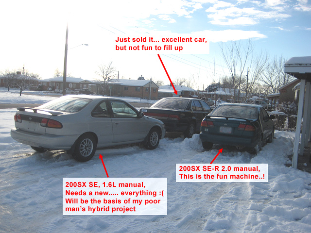

Just brutal! I haven't got much done on the bikes at all. I bought a car that needed some work which is totally ripped apart in the garage at this moment. I have a Crystalyte HS3548 and a 5303 just sitting there collecting dust as well. Just been too cold, even with the heater on, my hands freeze up after about 15 minutes.
Here's the car that's being worked on..
