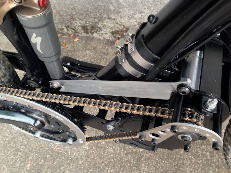

The to do list:
I will have to put a torque brace = bit angle alu, fixed this chain retension device hole.
Similar to this:
Similar to this:
Not sure you will be able to tighten up your torque brace if you put it there.
Also not sure the angle is enough to take out the twist.
try using the front shock mount with some mini hiem joints and threaded bar.
Darren
Darren
Darren this is my biggest fear at the moment with the choice of this bike I didnt really pay attention to the need for the torque brace.
Mike said the shock mount would function more as a pivot.,,,
So now I wonder whether I should do both.
I took a look at Heim on wikipedia, looks like an awesome invention but probably rather heavy and do I really need a bearing in there? Interestingly off topic designed by germans wwII for their air craft....
They make really tiny joints with the same dia hole as your shock bolt.
I did think the adjustable bar would enable you to tighten it really well .
What about the top shock linkage with a custom bolt in it? that looks in the right place.
Stick with it mate its nearly there .
Darren
its not a bearing its a floating olive type thing that means the 2 items do not need to be parralel.
Thanks for the input that Heim feature is a great tip.
I think for now I will try just going with the initial idea and see it handles, hopefully there is no irreversable damage to something, and I can then add the top shock point too..
