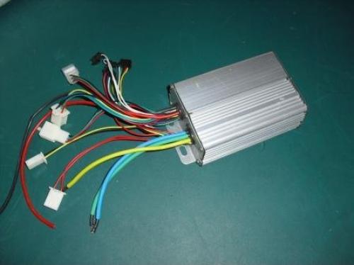

you have to run wires for temperature sensor inside motor , right?
inside controller cut on number of wires entering motor for sure.
I wondered about that. This isn't my controller in the picture, but it's somewhat like :
A controller in the hub wouldn't need the thick yellow/green/blue wires, but it would need everything else - battery power, half a dozen controls like throttle and brake, the computer, etc. Seems like quite a bundle of wires to go in the hub.
Right off hand I don't know for sure if there's any temperature sensor support on board, but if there is it hasn't been hooked up to an external wire.
