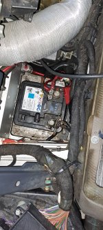

Picture from my installed battery.
I take the battery out at the end of the season.
On the battery is a sticker saying max volts 14.8V.
I don't know what Kind of BMS is in there.
So probably the bms is cutting out at higher voltages than i thought.
