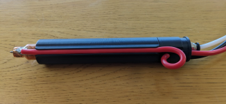

Yeh unfortunately nothing in this project is available off the shelf otherwise I would have used off the shelf parts obvs, everything is custom. You simply can't buy actuators with the required speed and accuracy so you have to build them, similarly you can't buy the current former you have to make it.
It can weld steel but it depends what you want to weld it to. What you struggle with is welding two materials with vastly different melting temps as you will vaporise one before it fuses with the other.
The stepper motor is a high quality unit designed to operate a feeder in a PNP machine, I have had it customised by the motor manufacturer to work in my weld head, I don't use it as a stepper at all rather as part of a highly precise very high speed closed loop actuator that I have developed specifically for this project. The motor is a good form factor for placing on the weld head and it isn't hugely expensive. The other CNC parts are just some small moving brass parts, electrode holder and the nozzle that acts as an argon chamber during the arc. All the other components are 3d printed in ASA (PLA also seems to work which is remarkable given the arc energy burst). 3d printing works for these parts as they contain internal gas channels that wouldn't be possible to fabricate on a mill.

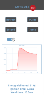

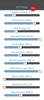

They don't control energy delivery, they just discharge a capacitor, total energy set by charge voltage only, they try to control current by switching in banks of power resistors. This effectively means you are running full current during retraction which will blast copper all over the electrode meaning it isn't repeatable.
They do not control the retraction position at all they just fire a solenoid meaning your fixturing needs to account for electrode wear and you can't control electrode pressure which means you can't press the copper onto the cell end at the point the weld pool with develop meaning it won't stick very well.
So overall they don't control the current waveform during retraction since they don't know where the electrode is which is critical for battery welding copper. Without control of the waveform wrt electrode position and pressure you don't have control of the weld puddle so anything can and will happen.
I believe most jewelry welding uses low double digit energy levels, I have found 70-90J of true energy into the arc after accounting for all losses is required for perfect welding of 0.3mm copper to cells.
