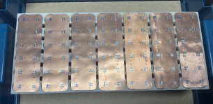

Since I'm building a 14s6p pack with 21700 cells (Molicel P45B) that can deliver up to 180 A, I'm trying to find the best solution for welding. On my CNC mill I can cut almost any shape and so I made holes and slots into the copper.
Sandwich welding the slots works good with 0.15 mm copper and 0.15 mm nickel, where 100 joule are necessary to get a strong connection.
But now I try building the busbars the other way. First weld the nickel strips to the copper, then turn it around and weld the nickel directly to the cell. Much less energy is needed, 20 joule or less per point. This should work with thicker copper, too. Another advantage is, you can't miss the pole when welding.
Has anyone experience with building this kind of busbars by themself and the currents they can handle? I had contact with a Chinese producer, but manufacturing and shipping is quite expensive, because of my custom layout, so I'd like to build it by myself.

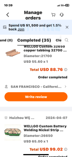

I thought getting them already made was pretty cheap. These prices are for 270 cells with .3mm copper and including shipping. Came quickly.

Maybe I've asked the wrong seller, but the answers came very slowly and they did not understand well, what I wanted. Finally the prices were much higher ($90 for 84 cells without shipping).
The battery I'm building currently is a sample. If it works and I know the final layout, I will try to order the busbars, because then I'd like to build a few more batteries.

I also did a CNC version as well, but I don't seem to have a thread about it here.
As to how much it can handle -- a lot. Most of the time I see people throw out numbers it's typically 3-4x what you'd get out of nickel, and considering you are laying down a sheet instead of strips, it's going to be even higher.
Given the 6p config it looks like you're using, I'd usually rate a nickel config at a max of 40-60A if you had the 6 nickel strips connecting across the series. If we work off a 50A estimate, then multiply that by 4 -- somewhere in the realm of 200A. The limit is, in this case, far more likely to be what your cells can handle outputting -- cells which could each handle a 33A output are pretty much only the top tier cells these days.
200 A, 11.2 kW, for a few seconds, no problem. The cells and the copper don't get significantly warm. The next tests will take a little more time, but before them I have to build a case.
Not only for a few seconds. Yesterday, two flights with the battery were very promising. 8 min. total motor running time, always enough power and finally the cells had a voltage of 3.4 V each and the temperature was 50°C. They would have worked a litte longer. But this was my first real life usage and I didn't want to stress them too much. Better than expected for a battery that has been built for learning how to weld and gathering experience.

The copper and the HDPE frame are constructed with Fusion 360 and cut with my CNC router, so they perfectly fit together and with the diameter of the cells.
These will be the parts for another battery (14s5p Molicel P45B):
