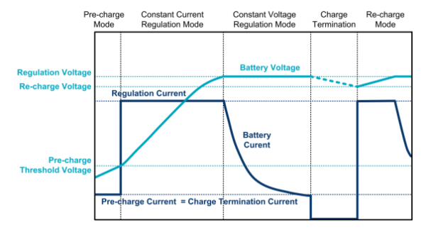

One of my lithium batteries has a small capacity. The 16 series iron lithium 58.4V5A charger can charge up to 58V or 5A, but most of the cells still have a protection of 3.65 when charged up to just over 3.4V. I hope there is a more obvious process of constant flow and pressure, for example, starting from 56V and then turning to 58V and dropping to 0.5 or 1A for slow charging. With the help of an equalizer, it can be fully charged.
