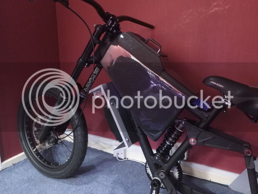

Hello crew,
Long time no see...
I change home, and I have a nice place for workshop.
I live in a nice area to ride an ebike, but do not have one. :cry:
The problem of the powerful hub motors, is the big weight. You lose the bike feeling. And that's a no go for me.
I'm going with another project, for the next decade... :lol: :lol:
I already buy the motor and controller. I buy a BMC, with gears, and the controller from HPC. Its going to be 3.600watts. Thats plenty. Still waiting to arrive.
I go with a carbon fiber frame. Never have one.
Batteries, maybe continue with the lipo route or try 18650. More incline for the cylindrical ones.

Hi guys,
Fidel, obrigado.
Vortecks, thanks. I follow your YouTube channel.
Wolfeman, great to ear from you again. I Want to believe HPC do some kind of upgrade to the motors... I don't read much about the motor, but i believe it's a nice and not so heavy hub motor. It have a temperature sensor ? If not, I try to install one. We will see, if I cook the motor on the first ride :lol: :lol: Jokes aside, if I can push continuous 2000/2500 watts, I be happy ...
