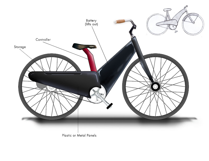

In my industrial design studio we are doing a group project to redesign some e-bikes. I have some sheerly aesthetic concepts for you to review. These were done by 4 different students so there is a reason they do not appear consistent. Pick 3 that you like the looks of the most, and I'd like to hear why you like them and what you would add/change to them.

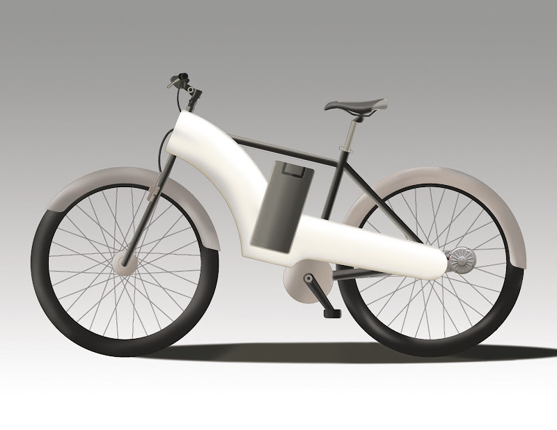

3 a 3b and 3c are nice. Most of the others have too much chain guard. The chain will come off, and then you will have trouble putting it back on the others. Those three have a practical look to them to me. 3c has a nice look to it to me, but like 2c the battery in front under the seat will be impractical and awkward. There isn't as much room there as it looks on paper, because your feet are on those pedals as they come to the top of the arc, and use more space that you realize till you put some battery there. Ok if it's narrow enough though. But it still leaves room only for a tiny battery. Dogman likes battery big.

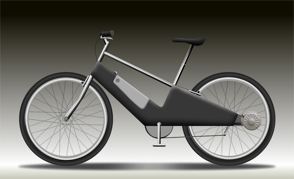

I like the look of 1a though, and the chain guard could be made to be openable to lube or put back on the sprocket. As the Designer of the EV Global found, placing the battery along the bottom tube between the headset and the bottom bracket is the ideal place for handling. And you could add another top bar for those who would not ride a sissy looking bike, or want to hang it from a normal bike rack on a car.
1b is good too, but doesn't look bike like enough for me. For some reason I object to the extra fairing under the seat.
1c strikes me as ugly somehow. just looks crude or something.
2a will handle lousy. Battery in the worst place. And again, too departed from normal looking bike.
2b looks kinda cool, but no fenders at all is no good. Same with any of them that lack at least a rear fender.
2c is not bad, but the battery placement won't actually work. It will make the rider have to bowleg too much unless under 4" wide.

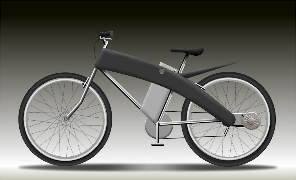

I left out panel 4. on that one,
1 has the battery where there is not room for it, like the others with the batt in front of the seat tube.
2 has the battery in the right place, but it will only be enough for Fabian Cancellara to do one breakaway. Like 1 mile range.
3 looks good to me. Greatly resembles an EVG.
