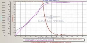

Thanks and hello, the project isnt dead and still gets developed slowly.
Here's one of the latest images.
As you can see, I now have new doublecrown fork, that I got from china for a fair price. I was planning to get one from the start but didnt have good options for it at the beginning.
I'm now going through second set of hobbyking batteries, lowered my charging voltage to 4.1v per cell to see how much it extends their lifetime. First set lasted me around 2.5 years or a little less, I was driving all year around, in winter too.
Using the old batteries for electric handdrills and such, they are still amazing capacity for those tools (hardcase makes for an easy attatchment). Looking into how to integrate those to solar usage too.
Also i'm now using new controller, the greentime 15fet "1500" watt, that easily does 2500 on my current setup so nevermind their silly labeling.. it's 72v rated for 50A so it falls flat on that equasion right away
No problems using it, it is actually surprisingly efficent and low temp.
Next up, new front headlights and turn signals to front too, right now only rear strips show turns, want front viewers to see my intentions too.
