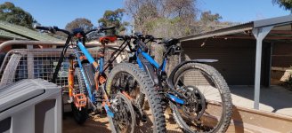

Anyway...I went for an awesome ride with Brian on the weekend, smashing a bunch of tight, twisty single track. Both our bikes performed brilliantly with no issues at all.
No video, but we did notice something...blue is not necessarily blue!
It's a bit hard to tell in this photo, but the shades of blue between my bike and Brian's are not the same. Mine appears to be a deeper blue, whereas Brian's is more pale.
They both look awesome though IMO. They also both ride nice and quiet with belts on both now. :D
I also noticed mine is noticeably heavier (2-3KG) than Brian's when lifting it into his ute. Probably due to the extra kit I have loaded on it with tools, spares, kits, and mud-guards, and the thick tube I'm now running up front after I gave up on getting it to work tubeless.

briangv99 said:
just to add to CDs post, can see the slight colour difference a bit more clearly here
I see the difference, both bikes look great. I like the orange blue combo. Until I saw it, I didn't think those colors would go good together. They do.

Glad the colours don't clash :)
Figured when I built it I needed something to distinguish it from CDs bike. Also don't mind a bit of bling that the Fox Factory suspension gives it.
