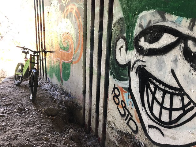

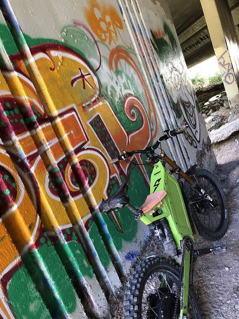

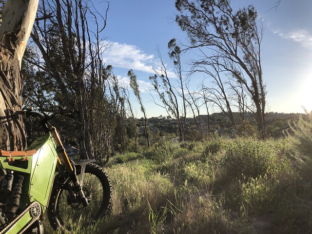

I really like the pics of your light green bomber out and about. Thanks for posting them ABV1. Always look forward to them.
Thanks man!! much appreciated! Here is a few more from some recent rides!
