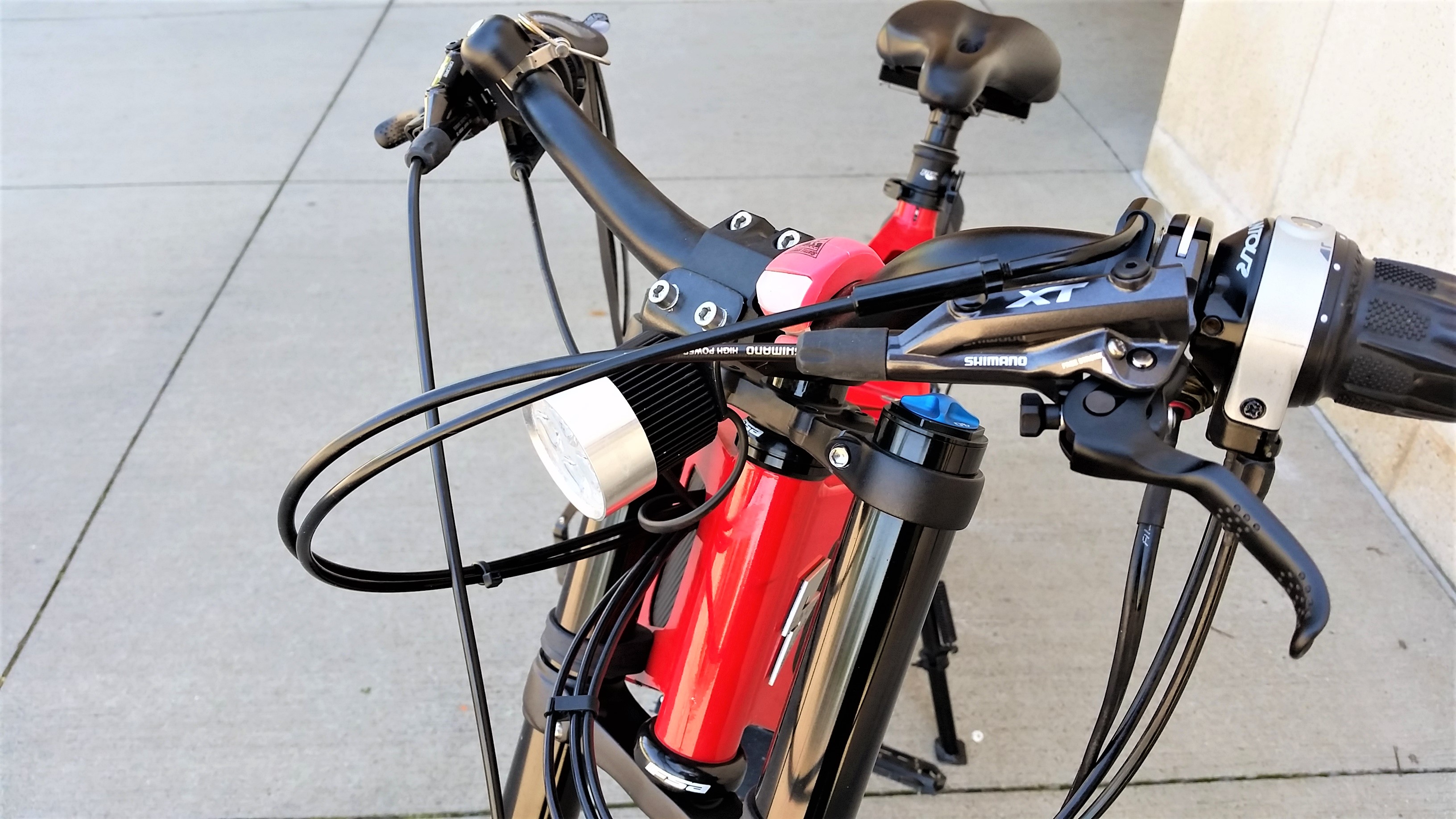

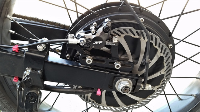

I dood it. I had to get a little creative in order to fit the regen button on. It won't fit under the bolt like stock. I moved the button to back side of the clamp instead of the front, and used a longer bolt, and nut to hold it on. Looks almost the same as stock. Makes no difference to me though, because I never use it.
I tried to be all neat and clean by sneaking up on the line after I cut it open, but 30 minutes later I was up tp my arm pits in mineral oil again. I was able to get a good bleed on it though, better than the MTs even though the process is identical.
I'm going to put some miles on them after dinner, and then I'll evaluate how they work.

Ok just got back from riding 25 miles. These brakes work ok. They have more stopping force than stock MT2s. They aren't amazing or anywhere close to that. If I had to guess I'd say MT5 are a tincy stronger. These have better feel though. In comparison I don't think these are as abrupt as MT5. They have nice firm linear pull, and because of the adjustable levers the travel is always going to be just right. They're so easy to modulate they're never going to be scary. The lever movement itself feels very precision. There's almost no wiggle, and the levers return to full open silently, even if you try to make them smack back, they still move silently, and smoothly. They have a classy, almost snooty, smooth operator look about them. In comparison MT2s have a more industrial working class look.
To summarize, I like these XT8000 Shimano's just fine. For a reasonable price of under $200 they're not only reasonably strong, but they also exude a high class taste you normally don't get in this price range.
The best thing about them is they're strong, but they're not strong enough to be scary, and the worst thing about them, they're not strong enough to be scary. :)
ps,
I forgot to mention the noise is gone. But still on occasion, usually at a slower speed, I can still make either one of them honk a little bit. I think Bombers are just really hard to make their brakes super quiet. I remember when my bike was pretty new I spent a lot of time fiddling with the brakes because of weird noises the brakes made. My sons B52 isn't too bad, but it's brakes aren't winning any awards for quietness either. Right now my brakes are quieter than I've ever been able to achieve so far.

eBikes always seem to have a mess of cable, and wire clutter in front of the handle bars, and it's hard to clean that up. The direction the hoses come out of these Shimano master cylinders is 90 degrees different from the Magura's. I wasn't sure how that was going to work out, but as it turns out it does help reduce the clutter for a slightly cleaner look. Both hoses are able to take a more direct route to their destination, without having to loop so far in front of the bike.
