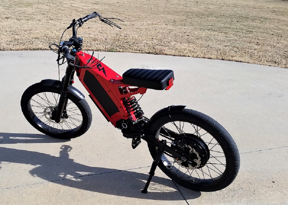

Odogster... Can you snap a photo of your bomber with the 72150. Like to see how it fits on the frame size wise. Are you still utilizing the cav3?
Thanks 👍
Sure will do. Unfortunately I can no longer utilize the cav3 the sabvotons aren’t compatible as far as I could find. However, the MQCON app that allows for all sorts of configuration options far outweigh the slight advantages the stock display has over the sabvoton ones. It’s incredible how customizable everything is using that Bluetooth app.
