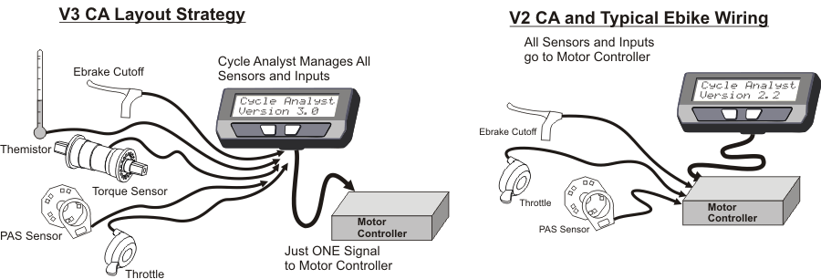

Some controllers require a full 360 degree rotation of the crankset to activate. I don't think the hub motor needs to be moving, but that is possible. There are hall sensors in the hub motor also. It is more expensive, but you could look at getting a Cycle Analyst v3 from Grin to connect the PAS sensor to. It would then send a throttle signal to the controller.
Cycle Analyst V3 - Grin Products - Our Products
