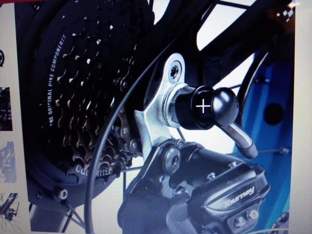

Hello mark! Here you go. Sorry I’ve been a little reluctant to really get into anything as I’m waiting on my buddy who owns tons of escooters/ebikes to come over and help me out!
Also bad pic because my phone camera is pretty old is I had to get really close for a good quality
which model do you have? heres the site
https://www.ecotric.com/
see the the + in middle of picture? look there for damage

Hello! I have the 26’ fat tire beach/snow model. And I just looked where you said that cord and area looks all good 👍
