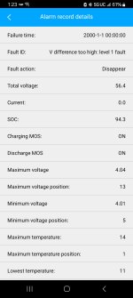

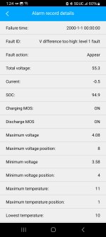

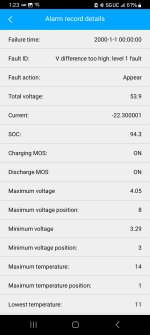

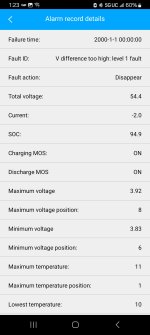

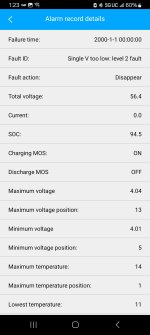

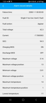

Could be wrong in understanding it, but screen shot two says the battery was at 54V, pulling 22 amps. and bank 8 was at 4.01 volt while bank 3 sagged to 3.29V. Is that right?
To me, that would suggest bad spot welds on bank 3. Are you a good builder and your batteries normally welded nice? It's 5P, and maybe two or three cells in that 5P had welds that lifted off. Or if you trust your craftmanship, then the cells are bad,
