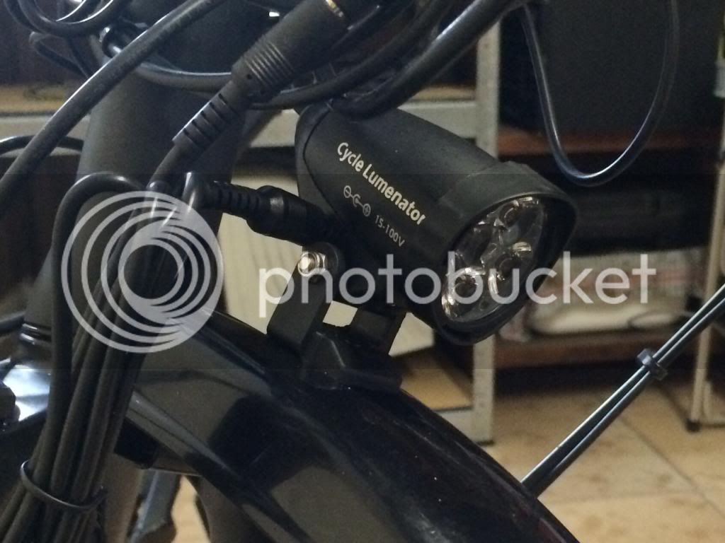

My mate and I ordered a couple of these, and I fitted mine the other night (multi-brightness version).
Awesome light, it has replaced my bikes stock 2w headlight and my bar-mounted XM-L. The two low beam settings are perfect for most lit urban environments, and the high beam lights up the dark paths and bush tracks extremely well.
I've got mine mounted on my front mudguard bracket -
The switch only just reaches my bars, but it's not going to on my mates bike as his stem is taller so for now his switch is on the stem. An option for a longer lead between light / switch would be good.
A word of warning - Don't mistakenly undo the Philips head screw at the base of the light! The nut on the inside isn't fixed to anything, so once the screw comes out the nut rattles around inside. I told my non-technical mate to take the pivot mount off so we could try mounting his to the guard (with the switch on the stem) but he undid the wrong screw. It took me a couple of nights to work out how to open the light up and then had to use a dob of silastic to hold the nut in place while I carefully reassembled it (there goes the warranty). All back in one piece now, and mounted up! Personally, I think that if it is that easy to stuff up then the screw should be a Torx or something less easy to remove...
