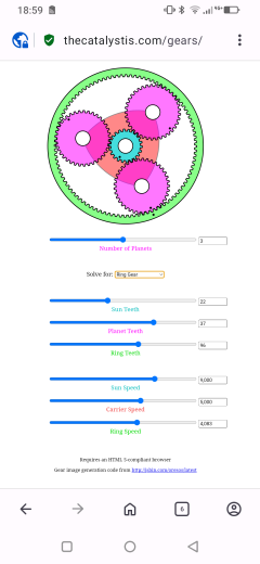

Here is a nice online tool to calculate the speeds of the sun gear, the planet carrier and the ring gear using the Willis equation. But I did not find an online tool, that calculates the resulting torques on each component :(
I thougt about that a little. For the planetary gear, the sum of all torques has to be zero, as we don't have any fixed connection to the housing. The torque on the pedals should be in the same direction as the torque on the chainring, as we don't want to pedal backwards for riding forward :) So the torque of the ring gear has to be negativ to fulfil sum of torques = zero.
Forward speed and backward torque means regen for a BLDC. (four quadrant operation)
If we want to have a similar gear ratio like on a typical 11 gear cassette (42 teeth chainring and 11-46 teeth cassette) the ratio is about 4:1 (42:11) So I've set the speed of the crank (planet carrier) to 2 and the speed of the chainring (sun gear) to 8. (Assuming the ratio of chainring to sprocket is 1:1 on this kind of system)
This leads to a positive speed of 0.61 for the ring gear with negative torque = regen.
