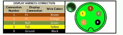

Jumpering the orange and brown conductors on the display harness connector will turn on the controller to default setting without a display. This will support throttle, and PAS at the default (highest) level, if you want to test the controller.

I would expect the BBS01 to use the same harness as BBS02 and BBSHD. Then the display connector coming from controller will be a green 5 pin Julet with male pins, Orange to Brown. or 1 to 2.
Always wise to verify first. . See if you get battery power between pin 1 and pin 8 first.

I get battery power, otherwise the display wouldn't be powered, right? And jumpering those pins did turn on the speed sensor, so something in the controller is on, but the PAS does not turn on. The display cable may have been shorted +36v to ground or to data once, are controller repairs something you'd recommend, or just replacing the controller?
