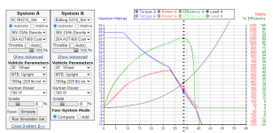

sorry, but this article says nothing. Just take a look at the grin simulator, my random choice of a DD and a geared motor shows, that this DD has more torque than this geared motor with the same controller settings.
If you adjust the controller settings, you can get a totally different picture:
If your primary concern is reliability and not weight, you should choose DD ;)

You're mixing degrees with percent.
