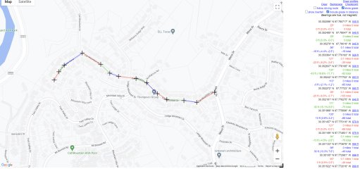

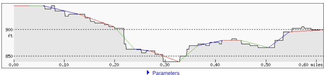

Austin has mostly gentle slopes, with plenty of exceptions. There's slightly more total vertical relief here than in Seattle for instance. I'm recently relocated to the old part of town that was reserved for black folks, because it was hilly and marshy in spots, which were disadvantages in horse-drawn days.
Here's a cross town section that goes pretty much from bottom to top:
I missed that. That could be the steepest street. Looks like it hits almost 20%.
