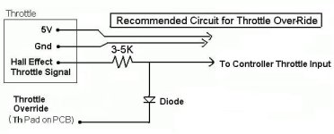

Ok, so I deleted a cheesey thread i started in the ebike technical forum. It only needed to really answer one simple question I have.
When using a 1k resistor to draw down the throttle signal for the LVC, where/how is a good way to set it up? Seems like an odd question, but I'm worried about it getting hot if it ever gets hot from LVC tripping. So, wrapping it in heat shrink and tying it in with the other two throttle leads is probably not a good idea.
Any suggestions?
You put the resistor between the controller and the throttle and pull down on the controller side. The resistor will not get hot, you can wrap it in heat shrink if you want.
The diagram below (courtesy of Justin) shows 3-5k, but I think 1K will be fine. The most it could pass is 5ma with a 5v supply. You don't need a diode either, the optocouplers can't backfeed the throttle circuit. Throttle interface.jpg
AHA!!!
That's exactly what I've been looking for!!!
As I did a search for this topic, I found a couple others on here wondering as well.
I just wanted to make sure I was doing it right. The diode was another question I was going to ask about, as I wasn't sure if current would go backwards through the circuit. But, as you state the opto's won't allow that.
Thank you.
